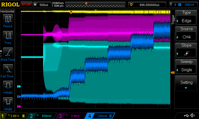

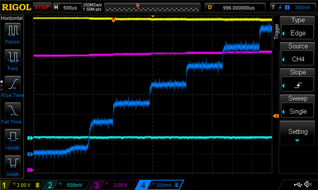

I have found that our BQ24125 circuit configured for 3S does not tolerate hot plugging to a 15V wall wart.
If we supply 15V via the bench supply we have no problem.
If we supply 15V via the wall wart where the AC supply is switched we have no problem.
If the 15V wall wart is powered when we connect the DC to the board, the BQ24125 fails.  In the case I observed it developed a switch node (OUT) short to GND, but I believe units from prior tests may have shorted switch node to IN as well.
We have 20uF mlcc at IN and 30uF mlccs at the output (after the inductor).
I followed up by hot plugging the wall wart straight into 10uF to 330uF capacitors, and the wall wart seems well behaved - there is no measurable voltage spike.
I cannot afford to destroy another board, so I won't be able to measure the inrush current.
Is there an inrush or hot plug limitation that I need to know about?
