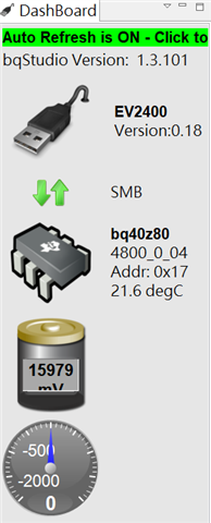

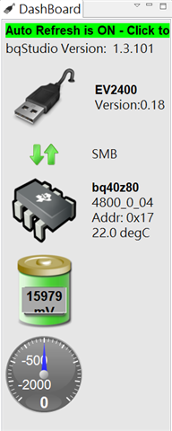

  • Mr. Keller,
    Thank you for solving my question!
    I want to ask another question that is about the bqStudio surface - DashBoard.
    The thing that I don't understand is what's the differences between the color of battery icon with gray and green.
    (I guess that the color of battery icon with gray is not normal. If it's not normal, how can I fix the problem?)
    Sincerely,
    Eric Tsai
  • Eric,
    The dashboard is not a critical piece of information. Please use the "registers" screen and refresh to get the critical information from the gauge. I recommend disabling the dashboard because it will constantly communicate in the background trying to determine which device is connected. This could impact some of your testing since things like sleep might require no communication.
    Eric Vos
  • Eric,
    But just for reference. It should be lighted based on SOC %.
    Eric Vos
