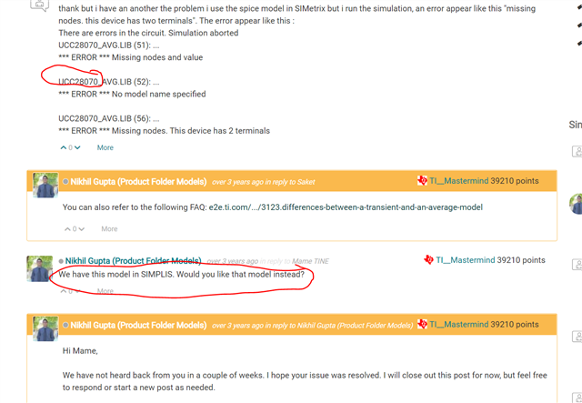

It was mentioned in the forum that UCC28070 simplis model is available, where can I find this?

  • Hi Ulrich,
    Seems like both the start-up and ac model model is running, question is, will i get thesame result as the Spice model for the AC and start-up analysis?
    Do you also have the simplis transient model, we are designing a new PFC ckt usingUCC28070 and I wanted to get simulation results first before going into actual lay-out. This will help me focus on using the part instead of looking at other similar devices from different vendor.
