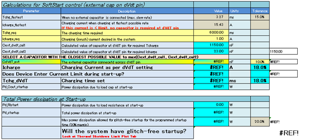

  • Thank you for your reply.
    1. It seems that calculator(rev.A) won't work with large charge time like attached picture.
    Am I using old calculator tool?
    Anyway, too long charge time like  > several seconds is not preferable in our system.

  • Hi Ryo,
    1. Yes calculator can not auto calculate cap for large charge time. You need to enter cap value manually .
    2. We havn't tried dynamic control during startup especially for DVDT . I think it will not work. ILIM you can change after startup to a different value. But problem with this startup in ILIM approach is that  device will start then hit thermal shutdown then restart then hit thermal shutdown. So it will add to charge time. You have to first test this approach on your system with lowest current limit for this device that is 2A.
