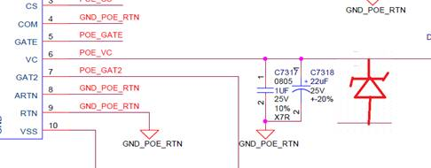

Dear team
the customer have one question, could you help to recommend.
About pin 6(Vc) of TPS23754, Does VC pin need to be protected by Zener(18V)?
Many thanks
Denny

Hi Denny,
I have seen customers add this in their system for more robust protection but in general it is not required.
You could add this in the system and then always DNP if not needed.
