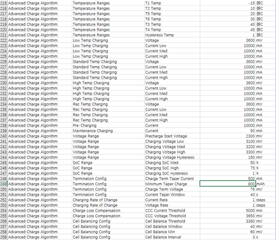

Hi
When doing the learning test, change the minimum taper charge 750mAh to 800mAh, the RSOC can not reach 100%.
How to calculate the minimum taper charge. I do not find this parameter from the TRM.

    I want to know the parameter of minimum taper charge.
    After change this parameter from 750mAh to 800mAh the battery can not charge to 100%.

    This parameter is normally a private one. Which version of bqStudio and FW are you using? This parameter should be left default, and is not used in the way you think it is, instead it is used for charge accumulation during the taper window. There is no way you will accumulate 800mA in 40 seconds.
    The parameter you want to configure correctly is the "Taper Current". Normally this value is in the C/20 range.
