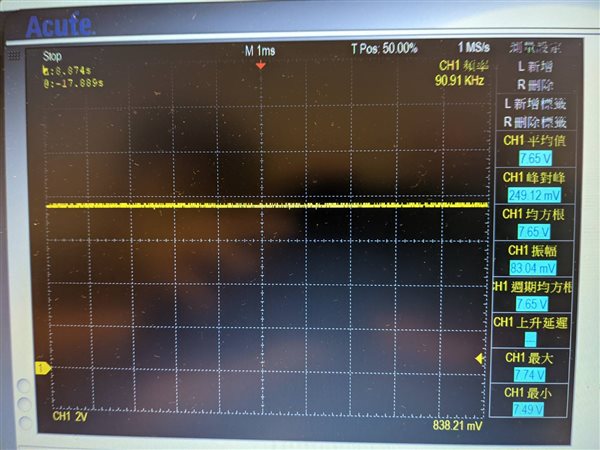

We used LM5121 for boost vin 60V to vout 70V,
but I have check UVLO above 1.2V, and Vin exist, but switching is no work,
Would you please help check schematic and waveform.

Hi
The chip has a normal VCC voltage. and the UVLO pin voltage is more than 1.2V, the IC should be work If the all parts value are correct.
From the schematic, it should be work.
Could you check whether the parts on the PCB board are correct?
Hi Dehuan,
Would you please add me to friend?
I need pass final schematic to you,
I have found many component value is different with webench suggestion.
If possible, need you help to check the value again.
