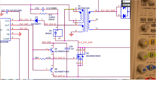

Customers use TI LM5022 as Flyback boost to provide PoE, PCB transformer occurs at a client burned.
The temperature exceeds 130°C. Product specifications:
VIN = 20 ~ 58V
PoE VOut = 58V
Wattage about 32W
VIN=58V full load efficiency 77%
VIN=20 Full load efficiency 88%
could you help check the LM5022 schematic as below and any need to adjust , and how do you adjust Duty
