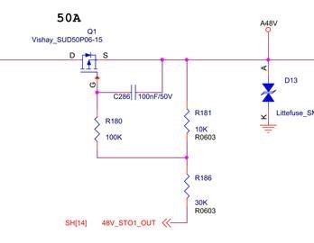

My customer has MOSFET burn out issue when short condition. The circuit is as below.
Their application is 48V/40A.
When they short Vout to GND, the current will up to 120A in 200us. This high current cause Q1 P-MOS damaged.
The efuse solution look like suitable to customer for short protection. But I found other thread say that LM5060 without short protection.
1. Could you provide best solution for short protection?
2. Why our efuse solution usually use N-MOS? Do we have P-MOS application efuse?

    N-MOS based solutions are efficient because of low Ron of NMOS when compared to same size P-MOS FET.
    What is the application use case and EE ?
    Do they need Q100 device ? If not, please look at LM5069 for hot-swap.
    For ideal diode solution, please look at LM74800

    This is Robot application.
    Customer just would like to have a solution to avoid P-MOS damaged when short condition.
    1. Do we have more easy solution? LM5069 is a powerful solution but customer don't need UVLO, OVLO or PG function.
    2. Could LM5069 use P-MOS for external switch? If no, could you suggest N-MOS solution also?
    Hardy
  • Hi Hardy,
    LM5069 can only drive N-MOS. Please suggest customer to use design calculator "LM5069 Design Calculator With FET Recommendation" which suggest suitable MOSFETs.
    We do not have simpler solution than LM5069 for this current level.
