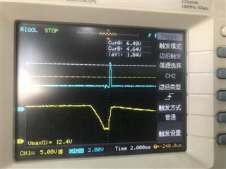

Overshoots occurs on VSYS_3V3  when the power supply in a special condition like quick off/on.
No direct issue happens related the overshot on VSYS_3V3, but it makes VSYS_5V0 having the same overshoot too,  the overshoot on SYS_5V0 may be up to 8V.
So issues happened on the device supplied by SYS_5V0, it will cause the CAN PHY broken since CAN PHY‘s VCC is supplied by SYS_5V0, and it also makes LM5141 being damaged since VCCX is connected to SYS_5V0.

    I think the info "Make sure Vin > Vsys_5V." is useful for us,   Like waveform below, when the overshoot pulse happens, it's the time after the Vout remain and VIN drops below 5V(about 3V) then quick rise up.
    I think it means no power for the chips but the output is still on ,after then there is a quick start, so it generates a high voltage.
    any advice and explanation about this and how to resolve it?
