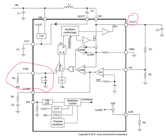

1.why the TPS61089 SW PIN direct connect with the Vout pin? And please help me explain the principle of the Vin and 1/K below BD.

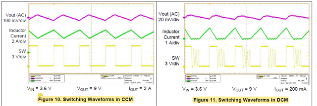

2.Below picture 10 and picture 11,you could find that the switch frequency maintain constant. it seems the switch off-time became more large for maintainning the const frequency. So I wanna konw if it means the switch frequency will not change in the(ps: conflict with constant off-time? ) peak current mode. And is there a sub-harmonic oscillation when D>0.5?

    1. The SW pin is not connected directly to VOUT pin. They are connected through high-side MOS.
    For CCM Boost,Toff=VIN/VOUT/fsw. For frequency setting, it uses a current source proportional of VOUT to charge a capacitor through R3, when the capacitor voltage is charged to a voltage VIN/K, the capacitor is discharged at once and the cycle is reset. So Toff=R3*C*VIN/VOUT and f is almost constant as 1/(R3*C).
    2. The switch frequency is basically constant but it actually changes a little according to working condition. And that is why there is no sub-harmonic oscillation issue.

    The datasheet refer constant off-time peak current mode control. But in the DCM mode, I find Toff will change to maintain const switch frequency, So is there a conflict with the formula Toff=R3*C*VIN/VOUT(ps:constant off-time)?
  • Hi Gordon,
    The practical circuit is more complex at light load condition. Larger Toff is needed so there is other circuit to achieve this.
