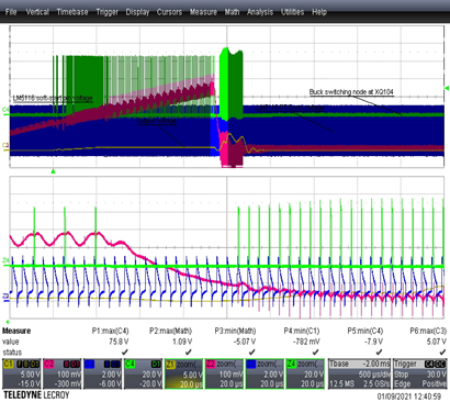

I have a LM5116 controlled buck converter that is having  a few issues during short circuit. It is used in a multi-output converter so is synchronized to an external clock via the RT pin.
During overload or short circuit switching stops as expected after 256 cycles, then about 100µs later the High-side driver kicks back into life causing the output to rise again as shown below:
If the external clock is disconnected and the LM5116 allowed to free run the short circuit behaves as it should, initiating a proper hiccup cycle after 256 cycles. For reference I'm using a 10µF ceramic as my UVLO capacitor.
Looking at the block diagram I cannot see any obvious reason why the behavior would be different.

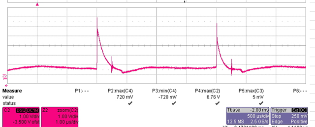

There is a little overdrive above the recommended 5V, but the sync signal appears to be within the limits allowed by the datasheet:
Any ideas as to what might be upsetting the chip?
(NB. Vout, HO, LO and SW are all clamped heavily at the chip's inputs to prevent negative over-voltages)

    Thank you for replying. You are right that short circuit is not perfect. Most of the testing has been carried out using a contactor to short the output, (when we don't mind blowing the unit up) or a heavy overload of 200% nominal load (when we don't want to have to rebuild the unit). Even a contactor on short leads does not  present zero impedance - when the short is first applied the lead inductance rings with capacitance in the circuit swinging Vout below ground. This really upsets the chip so we have clamped pin 10 with a Schottky and series resistor (pin 10 was directly connected to Vout). The plots I shared were taken with the heavy overload.
    Our main concern is that the uncontrolled High Side switching in this condition could saturate the choke if a short is applied. Also the Low side does not appear to switch during this period, and as far as we can tell from the block diagrams the circulating current is only sampled when the low side switch is on?
    Quinn

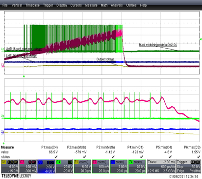

    I cannot duplicate the behavior which you mentioned on the bench, but  I think it is most likely because the SS capacitor is not fully discharged after the 256 cycles of current limiting. If a noise is injected (by the external synchronization clock) to either UVLO or AGND, the device may restart immediately after the 256 cycles of current limiting without pulling down SS. Please compare SS with/without the external clock.
    - Eric Lee (Applications Engineer)
  • Hi Eric,
    Thank you for your reply
    Without synchronization it looks like this:
    (green = SW, red = SS)

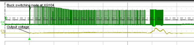

    With synchronization it does this:
    Quinn Kneller
  • Hi Quinn.
    The datasheet says in the UVLO section that at higher switching frequency (greater than approximately 250 kHz) the hiccup timer may be disabled if the fault capacitor is not used. Based on this description,  I think the external clock signal is coupled to inside the device (especially at UVLO pin)
