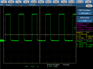

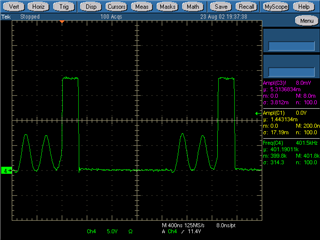

3) -9V, Here we have problems
3a) we hear audible noise when Vin is 12V and the load current exceeds 600mA
3b) we have negative spike when Vin is 24V
Vin = from 12V to 24V
Vout = -9V
Iout_max = 1A
3c) no load switching point Vin 12V (PFM)
3d) no load switching point Vin 24V (PFM) -> negative spike
3e) 50mA load switching point Vin 12V (PFM)
3f) 40mA load switching point Vin 24V (PFM) -> negative spike
3g) 200mA load switching point Vin 12V (PWM)
3h) 400mA load switching point Vin 24V (PWM) -> negative spike
3i) 700mA load switching point Vin 12V -> audible noise
3j) 500mA load switching point Vin 12V -> transition to audible noise

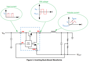

  • Hello David,
    In the bottom-most design, you are experiencing some level of  instability.
    Given in IBB design, a RHP zero is introduced into the transfer function, these devices, which internal compensation is geared towards 1/10-1/5 crossover frequency of 400k-2.1M, now requires often a large feedforward capacitor to increase the phase prior to crossover frequency, which I can assume is sub 20k.
    It looks like you have injection resistor placeholder in FB network. Do you have frequency response analyzer available to use?
    I would like to determine actual crossover frequency, then we can see the required CFF to stabilize.

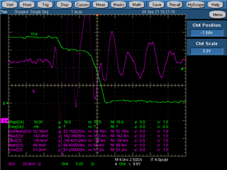

  • Hi Marshall,
    here are the measurements, please note that we had to set -9V offset on the scope in order catch the transient response.
    If we are measuring correct the f_cross = 22kHz, according to SLVA289B
    Page 5 figure 7.
    David.
  • Hello David,
    That measurement makes sense to me and we can see quite clearly you have a stability issue.
    I suggest performing the calculation on required CFF and performing the same measurement to see the delta.

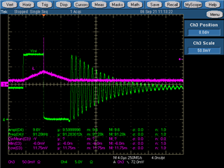

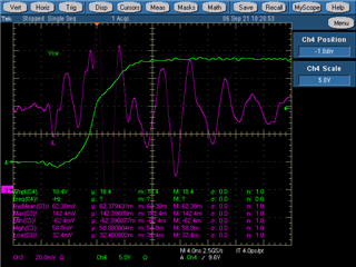

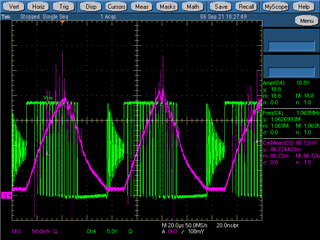

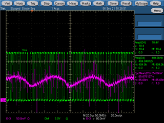

  • Hi Marshall,
    we measured the current through inductor ( we soldered 100mOhm resistor between IC switching pin and inductor).
    1) Vin = 12V, I_load = 0A (no load) , no cff
    2) Vin = 12V, I_load = 100mA  , no cff
    3) Vin = 12V, I_load = 500mA  , no cff
    4) Vin = 12V, I_load = 600mA  , no cff, transition
    5) Vin = 12V, I_load = 650mA  , no cff ( current hits the 0)
    8) Vin = 12V, I_load = 850mA  , no cff ( current hits the 0)
    David.
  • Hello David, Plot 8 looks unstable. I would advise going ahead with cff implementation. The design resource I shared give the step by step on the calculation. If you would like for me to review I can.

  • Hi Marshall,
    Yes you are right about output capacitors, we increased output capacitor from 4x 10uF to 8x 10uF and now we have stable system on output current of  500mA and higher (I checked up to 900mA, and there is system stable)
    1) 24 Vin, 500mA step response
    2) 12 Vin, 500mA step response

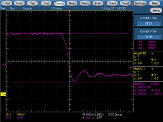

    I have another question about negative spike at the switching point, looks image below
    3)Vin 24V, Without load
    It's that normal behavior? Lower value should be -Vout, he have additional 5V in this spike

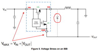

    Maybe we should  use parallel diode like on image below? This image is from Application Report SNVA856A page 6., we didn't find any explanation regarding this parallel diode which impact it has on waveform at the switching point.

  • Hello Mateo, that is good to hear.
    In regards to negative spike, that seems OK and in the ballpark for what I would expect with a wirebound, hard-switched DC/DC.
    To ensure it is minimized, make sure that you are following layout best practices in the datasheet. If you would like me to review your layout, please open a separate thread for layout review.
    The diode you mention is in regard to a non-sync solution. You are utilizing synchronous control with your converter selection so you need not consider.
