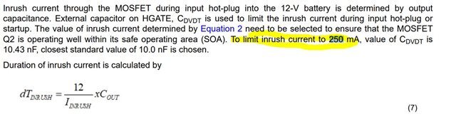

I use datasheet to calculate the CdVdT. The value is around 145nF. But customer only have 470nF in customer factory. Can you let me know if there is any potential risk that we place much higher cap for CdVdT?

    I follow the datasheet in the beginning, inrush current = 250mA. The calculation result, CdVdt = 145nF. It may be a little large. Our condition is below.
    Cout = 660uF
    Iout = 7A
    Roy

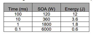

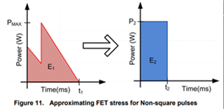

    For your understanding below is a step by step procedure (extracted from the app note),
    1. Calculate the power stress on the FET during startup. Refer to section ‘2.3.3 Checking SOA for Non-Square Power Pulses’ of the app note.
    Derive t2. Approximation here is  that the FET is stressed for a power loss = P2 = PMAX for t2 duration.
    2. Now, estimate SOA the FET can handle for t2 duration. This value will be at room temperature. Refer to section ‘2.3.2 Checking SOA for Intermediate Time Intervals’ of the app note.
    Remember that the SOA value in the table below needs to be taken at VDS = VIN(max) in the SOA curve of the FET.
    3. Now, De-rate the SOA calculated in the above step for the Max operating junction/ case temperature of the FET. Refer to section ‘2.3.1 MOSFET SOA Curve and Thermal Model’ of the app note.
    This value can be taken as the temp. of the FET at max load condition,
    4. You can consider that the FET has strong SOA if
    SOA(TC) > 1.2 x (P2 / VDS)

  • Hi Praveen,
    Thanks for information. But I still have confusion about inrush current parameter. In datasheet, the parameter is 250mA. I have no idea how to define this parameter. May you give me some comments?
    Roy

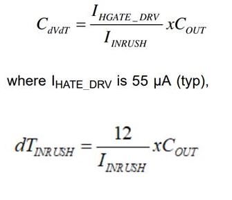

  • Hi Roy,
    During dvdt based startup, the slew rate of output voltage will be equal to that of gate voltage.
    Igate = Cdvdt * dVgate/dt
    Iinrush = Cout * dVout/dt
    Since, dVgate/dt = dVout/dt
    Igate/ Cdvdt = Iinrush/ Cout
    Igate = 55uA , Cout, Cdvdt are known. now calculate Iinrush
    Using this Iinrush calculate the stress on the FET and SOA margin. If there is no enough margin, change the Cdvdt and calculate Iinrush and SOA margin once again until the SOA margin is met.

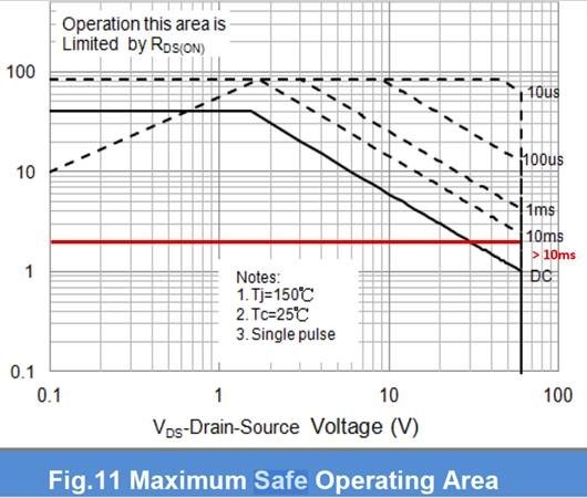

    Thanks for information. Can you help check my design flow?
    Formula.
    Design flow
    1. IHGATE = 55uA, Cout = 660uF(typ), Design IINRUSH is 2A, and we can get CdVdT = 18.15nF(typ)
    2. Use IINRUSH = 2A to get dT and and also set Vin = 12V, dT = 3.96ms.
    3. Below is MOSFET SOA chart, We use worst case.(right line) VDS = 60V, when current is 2A MOSFET can accept dT> 10ms. 4ms duration is in SOA spec.
    Roy
  • Hi Roy,
    You need to consider the below points while calculations,
    1. The total current flowing through the FET will be = Iinrush + Iload (if there is load during startup). Therefore you need to verify the SOA for Iinrush + Iload
    2. The SOA has to be verified at Vin(max) and not 60V (VDS(max) of the FET)
    3. During startup the power stress on the FET  reduces as the Vout starts raising. This is because the voltage across the FET (Vin-Vout) reduces as Vout starts ramping up to Vin. Follow step 1 and 2  specified in ''FET SOA stress calculation"
    4. Now the SOA has to be derated for temperature before calculating SOA margin. Follow step 3  specified in ''FET SOA stress calculation" .
