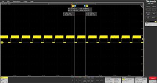

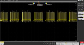

4) Buck1 voltage when reads is at 1V8 but the waveform is as below (Rail, SW, GPO1(+Rail in red))
5) Buck2 voltage when reads is at 0V85 but the waveform is as below
After these 2 Bucks there is no outputs from any of the LDO or BUCKS.

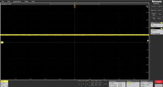

  • Hi Sandeep,
    Can you get a scope shot of the device powering on with VSYS, LDO3P3 and LDO5V0?
    Additionally, can you share a schematic of your design using the TPS650864?
    Daniel W
  • Hello Daniel,
    Scope shots for,
    1) VSYS
    2) LDO3P3
    3) LDO5P0

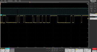

  • Hi Sandeep,
    Can you take an analog scope shot of the I2C lines during communication to ensure that they are hitting the appropriate high and low voltages? Additionally, please note that the pmic only supports 7-bit addressing
    Daniel W
  • Hello Daniel,
    Please find the below waveform form the scope and to our surprise, we were able to get ACK today. Don't know what different we did expect added scope probes to capture analog waveform of I2C. So we are in a process of reading registers to understand the Fault. I will keep you posted once read and then we need to see why PMIC is in Power fault state to resolve it.
    Zoomed version,
    Thank you,
    Sandeep P

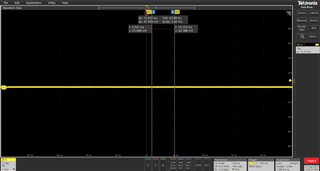

    For the power fault questions, please include scope shots of LDOA1 and LDOA2. Additionally, I would recommend using the PWR_FAULT_MASKx registers to mask each one of the rails you are seeing faults on one at a time to see if faults persist when the pmic is not continuously restarting. Additionally, if you mask the LDO power faults do you still see one on Buck2?
    For Buck2, an overcurrent could be causing a powerfault if all supplies to the buck are good.
    Please et me know what you find
    Daniel W
  • Hi Daniel,
    1) So does this mean whenever we do power cycle to PMIC we need to initialize (Read- Check for issues-Write- Read) it to check for any such issues and clear them and then proceed with powering sequence?
    2) Please find the scope shots for LDOA1 and LDOA2.
    LDOA1:- (not used in design)
    LDOA2:- (not used in design)
    LDOA3 :- (Used in Design)

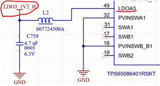

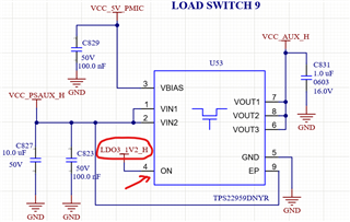

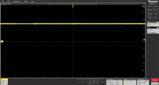

    2) I am using LDOA3 output to turn ON the load switch (TPS22959DNYR), so as per datasheet it can be driven with a GPIO pin of microcontroller, so the current requirement is less then 10mAmps to 15mAmps. I did take the scope shot of LDOA3 output pin and its showing zero and no power fault signs in the waveform and input to this is 1V8 on pin 50 (PVINLDOA2_A3)
    LDOA3 output scope shot.

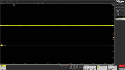

    1V8 on pin 50 (PVINLDOA2_A3) scope shot

    2) When you say turn on the load switch do you mean that this LDO is connected to a CTLx pin which controls that load switch?

    2) No. Actually we are using a separate load switch from TI (TPS22959DNYR) and it has an Von pin which is connected with LDOA3 output from PMIC. we are not connecting any CTRLx pin in this path. below is the circuit snapshot.
    Thank you for your support,
    Sandeep P

    Today we tried to add a Cap of 4.7uF/25V 0603 package on Pin #9 (LDOA1) and Pin #51 (LDOA2) bypass it to GND. Well initially there was no change in the output and we were seeing the same old Power faults & PMIC shutdown pattern on scope.
    So next step to debug was to remove the pull-up on GPO3 line and this helped around 50% and we started seeing outputs for Buck1, Buck2, Buck4, Buck6 & GPO1 (This is the first time without I2C programming we are able to see these rails up.)
    But rest of them are still having issue and are not up and those rails are Buck3, Buck5, LDOA3,GPO3 and GPO2 all are showing 0V and there is no power fault or shutdown of PMIC.
    We are really not able to understand the logic behind GPO3 pull-up causing issue and not sure why LODA3 is never up (even when we did force ON using I2C). I think if we can resolve these 2 issues we may get through rest of them.
    Please suggest if you have any inputs on this behavior.
    Meanwhile tomorrow we are going to repeat adding caps on a different PMIC (U29) and see what is its behavior.
    Sandeep P

  • Hi Daniel,
    Today I tried adding the caps for LDOA1 & LDOA2 of PMIC U29 which is a another PMIC on the board. But unfortunately still we see power fault on that as well.
    Coming back to your recommendation, on providing external power, In order to do that we need to cut the power traces of those pins and then provide a decap. I have requested my manager for doing this change on the PCB and will let you know once done.
    For LDOA3, removed Inductor and provided a 0ohms resistor and still there was no change in the output as is 0V. please find the scope shot.
    For GPO3, I was able to capture scope shot and it is showing as below without pull-up and with pull-up.
    Sandeep P
  • Hi Sandeep,
    Thank you for the information.
    So even though GPO3 never goes high with or without the pull-up, the previously listed resources (Buck1, Buck2, Buck4, Buck6 & GPO1) only turn on when there is no pull-up connected to GPO3.
    This means that without the pull-up there are no power faults from LDOA1/2.
    For GPO3 coming up, without a pull-up there would be no way for this to be up since it is open drain.

    Today we tried the above mentioned point#1(only) and below are my observation,
    We replaced 10K ohms with 100K ohms for the pull-up on GPO3(in-turn connected to CTL4) and GPO2 (in-turn connected to POR of ZU3 FPGA) and to our surprise all the outputs became zero and there was no power fault pattern on any of the power rail.
    We did checked the inputs/outputs of PMIC (VSYS,CTL1, LDO3P3 & LDO5P0) and below are the scope shots. All were good.
    PMIC_U24_100K_pull-up.zip
    Buck2 SW signal was not as usual and LDOA1 , hence we added there scope shots for your review. Rest all of them were zero volts, hence did not capture them.
    At this point we just got lost and did not knew what was happening with PMIC, and to this even other PMIC which we powered up the day before for the first time is already in power fault even after providing 4.7uF/25v caps on  LDOA1 & LDOA2.

    I noticed that SWB1/2 are unused but in the power sequence it is stated that they are triggered to come on at 1.8V to create a powergood signal.
    In order to prevent a powerfault from these please add an input source and bypass capacitors to the output.

  • Hello Daniel,
    The surprise part for the day was U24 PMIC which was showing no pulse until Friday evening, suddenly today morning it showed all the outputs. Hence was able to capture below scope shots.
    As per our discussion in Friday's meeting, please find the scope shots when CTL4 is supplied with 1V8 as in put from external source.
    Case1: Scope shot of LDOA1 Input & Output captured when CTL4 is applied with 1V8.
    Case2: Scope shot of LDOA1 input & Buck3 output captured when CTL4 is applied with 1V8.
    Case3: Scope shot of LDOA2 Input & Output captured when CTL4 is applied with 1V8.(Note: In this case we are seeing power fault pattern in Input  for LDOA2 because that supply of 1V8 is provided from Buck1 of same PMIC U24)
    Case4: Scope shots of power fault observed on other power rails when CTL4 is applied with 1V8.

  • Hi Daniel,
    The scope shot setting is set to Top , so while doing single shot capture with trigger we could see the top voltage level as reading but it is just a spike of noise and not the actual level of the signal.
    To clear this we took scope shot of I2C-SCL & I2C-SDA separately and you can see that its within the limit of 3.6V as per datasheet. Also captured the Saleae tool data logger to show the NACK.
    1) I2C-SCL
    2) I2C-SDA
    3) Saleae tool data logger output.

    Today we verified the 3rd PMIC and unfortunately even this PMIC has power faults. All the Inputs to the PMIC are available and good , but we could see power fault pattern in Buck1, Buck2,  Buck4 LDOA1 & LDOA2. But Buck3, Buck5, Buck6 and LDOA3 are all at 0V.
    We even provided the de-cap of 1uF for LDOA1 but still power fault was present, below is the scope shots of the power faults rails& inputs to PMIC only because rest of them are at 0V.
    3rd PMIC U21.zip
    But one positive note that we observed here is, if we GND CTL1 pin then those power fault rails are going to 0V level. So we are assuming it may behave similar to 1st PMIC (U24). So we will have to debug further on CTL4 line behavior to see if that is source of power faults.
