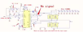

Hi team
My customers told me that he met a wave form issue, please refer to the file below to get more details

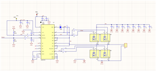

    If I understand correctly, their switching frequency is 200kHz (50% duty cycle), Vin = 12V. What's their Vbus voltage?
    From their schematic, seems like they are using 100nF cap for the bootstrap capacitor and the VDD capacitor. We recommend the VDD capacitor to be at least 10 times larger than the bootstrap capacitor. Can you please ask them to increase one of the VDD capacitors? They already have 1nF, they can change the other VDD cap for a 10uF cap.
      Vbus = 12Vdc
       bootstrap capacitor = 0.47uF + 0.47uF
       VDD capacitor  =  100uF / 25V + 0.22uF +0.22uF
     20210910.LMG1210.docx
    The attachment is the English description document
      Looking forward to your reply and best wishes to you,t.k.s.

  • Hello Leslie,
    Thank you for your reply. We have tried to remove the 30 ohm test resistor. When the test condition is EN=5V PWM=20Khz~1MHz, most of the board's HO pin has no signal, and some of the board's HO pin remains high and large. The LO pins of some boards can be tested to normal PWM signals.

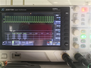

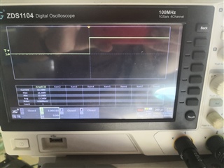

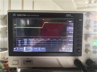

      I have obtained some waveform data, please help me analyze it, thank you。
      VDD,
    VDD-VSS wave
    EN,
    PWM.
    LO,  (YELLOW,pwm   GREEN, LO)
    HO-HS  (GREEN HO-VSS      &    YELLOW  HS-VSS)
    HB-HS
    Thank you for providing the plots. I'll analyze them with our team to give you feedback by tomorrow.
    Does this issue happen during startup? Does HO signal eventually starts switching?
    The reason I ask is because there is a startup delay that you need to take into account before you start switching the low side and the high side. The optimal startup sequence is to rise VDD voltage level about UVLO and then wait tSTLS (150us) before switching the low side. Similarly, once HB-HS voltage level is above UVLO, then you should wait  tSTHS (28us) before switching the high side.
    Leslie

        Except for the moment of power-on, the HO pin is always low during the rest of the time, but the LO pin is always a normal PWM output。
    I have 40 PCS LMG1210 chips now,But  most of the circuit boards are like this.

    Thanks for providing the waveforms. It seems like HB to HS voltage level is staying at ~0V. I think it would be best to test the driver by itself to make sure it is working correctly.
    To understand if the driver is working correctly, you can turn off the Vbus voltage (VIN on your schematic) and remove the load and test this way, and monitor HB to HS, HO to HS and HS to VSS.
    If you are still seeing the same behavior, you can then check the basic functionality of the driver without any load, Vbus or FETs. In this case, you would remove the FETs (you can do this by removing the gate resistors) and short HS to GND. This way, you should be able to see both high side and low side signals switching (both with respect to GND).

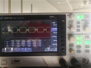

  • Hi Leslie,
       We have confirmed that HB-VSS HO-VSS is always 0 after many times, except for the moment of power-on.Almost all boards can output normally on the LO pin.
    I just followed your suggestion by removing the drive resistance and turning off Vbus, but the situation remains unchanged.
    Does this mean that the IC I got is faulty?
    PWM:     100KHz
    VBus = 0
    No FETs
    YELLOW :  LO
    GREEN   :     HO

  • Hi Youcai,
    Thanks for the information. Just to confirm, when you did this latest experiment, did you short HS to GND?
    I think it is unlikely that these are defective ICs (specially since you are seeing several of them showing the same behavior) since all the devices get tested in production. I sent you a friendship request to be able to discuss in private messaging further debugging steps in more detail.

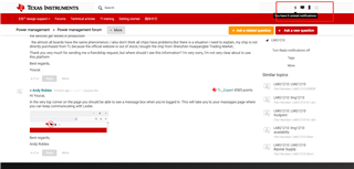

    Thank you very much for sending me a friendship request, but where should I see this information? I’m very sorry, I’m not very clear about to use  this platform
    Youcai
  • Hi Youcai,
    In the very top corner on the page you should be able to see a message box when you're logged in. This will take you to your massages page where you can keep communicating with Leslie.
    Andy Robles
  • Hi Andy,
      Thank you for the screenshot,have a good day

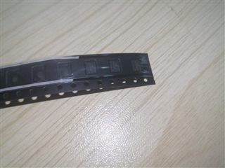

    With these devices being purchased from the Shenzhen Huaqiangbei Trading Market (SEG Plaza?), I know there are many devices being sold here, many of which can be fake.  I will check internally if there is a way to check the authenticity of the devices.
    In the mean time, could you please help with the following?:
    1)  Provide a close-up picture of the devices so that I can read the numbers on the chips?
    2)  Provide a picture of any documentation that came with the devices.
    3)  Check to see if there are any short circuits on the board from HO to HS and HO to GND
    Like you said, if possible, it is always best to purchase devices directly from TI.com
    Aaron Grgurich

         Thanks for your help,I bought the chip from a distributor in Huaqiangbei, because the official website is not available.
    Reply to Question 1,Close-up picture of the devices:
     The printing on the chip is LMG1210  TI 98J  P8YH
    Reply to Question 3,We have confirmed that HO to HS and HO to GND are not shorted to GND
    reply to question2 "Provide a picture of any documentation that came with the devices."
       I did not understand what you mean, is it my application schematic?

    Regarding my question, I was wondering if you could send a picture of the box or bag that the devices came in (with any labels, etc).  No worries if you cannot find it.
    Thanks for the close up photo of the parts!  I will check with our internal team to see what conclusions we can come to.

      I got chips from two suppliers,One is packaged and the other is in bulk

     Thanks for your reply,As I reported, almost all the HO chips have no output,We had tried to remove the drive resistance test chip according to Leslie’s suggestion.
      I have two circuit boards, all parameters are exactly the same, it can work normally, the waveform is also normal, only 2
     At present, I can’t find any other possibilities, maybe the only possibility is that the chip I got should be abnormal

    My name is Jim Davenport and I am the TI Anti-counterfeit Program Manager. I am sorry to inform you that Shenzhen Huaqiangbei Trading Market is not a TI authorized distributor. Due to uncertainties in the supply chain regarding chain of custody of the products, TI will only support product verification requests from customers who purchase through authorized distributors.  All other verification requests must be worked through their supply chain.
    Please refer any further inquiries or  information to ti-counterfeit@list.ti.com.
