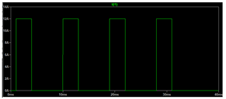

Currently we use TPS26630 chip as automotive application. Our customer request us to pass the waveform of peak 12A 3ms duration with 6ms spacing.
However TPS26630 can not withstand the pulses, we pretend to change the TPS26630 to TPS26631 due to the pin 2 pin, could TPS26631 withstand the pulses as the following waveform?
please help review the schematic if we change the chip to TPS26631.
Vin: 10-16V
I: continue 3A, peak 12A 3ms duration with 6ms spacing, there can be up to 4 pulses per second
thanks
