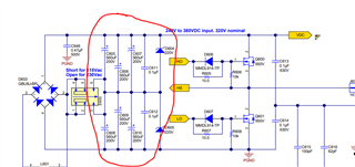

  • 0247.schematic.pdf
    Hey Manikanta
    Thanks for the quick reply. I have attached the schematic(pdf and Jpeg) and the BOM of my design again as you mentioned the previous zip files got corrupted. Please let me know if you can access these files now.
    Thanks for making all the points, they were pretty informative. I have a few things I would like to discuss as referring to the points you made as follows-

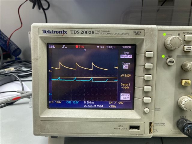

    2)I have measured the HO & LO pulses with respect to the ground using a single-ended probe. Is that an issue? For measuring HO wrt HS, I will use a differential probe. As you mentioned the converter will not work when the single probe is used for measuring HO wrt HS, can I use a single-ended probe to measure HS and HB wrt IC ground? I have attached the results in the main post after point 2. I currently don't have the differential probe and have ordered it.
    3) Also I can see the RVCC and VCC continuously varying, I think as you mentioned it is going into UVLO but what should be done regarding that? Can you please guide me.I have varied the input voltage from 180VAC~240VAC and it looks like IC stops switching below 180VAC and restarts only after 180VAC.
    These are the RVCC and VCC voltages I am getting on the CRO.
    4) As for the voltage across Cboot Capacitor, I am measuring using the single ended probe. The Cboot voltage is mean ~3V.
    Yellow-Cboot     Blue-LO.

    Ch1- RVCC          Ch2-VCC
    I am still having trouble running the RVCC and VCC continuously and the IC is switching every ~1.2sec.

  • Hi Rahul,
    Please find my observations from your schematic and design calculator:
    1. Output diode and primary side mosfets should be rated as below:
    However, the rating of the devices you picked are lower than the recommended values. So, those devices might fail when you operate at full load.
    2. primary to bias winding turns ratio should be at least 10.5 according to the design file. In the schematic I found out that it is less than the recommended Value. It might effect VCC voltage. If this voltage less than the threshold, converter wont be able to start.
    Except these two, I did not find any other issues in your schematic.

    None of the waveforms are clear except VCC and RVCC signals. Because all the waveforms time scale is very small.
    We can see that RVCC voltage not going to zero volts, which means controller is not in fault state. So, I suspect that BLK pin voltage keeps oscillating and going beyond threshold voltage. You need to increase the input capacitance at the rectifier output like below. Those capacitors will carry enough energy during line voltage is decreasing.
