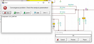

What is the meaning of error massage "Component: U3.X_M47.M1"?

  • Hi Nam,
    1. What is the meaning of error massage "Component: U3.X_M47.M1"?  . Does "U3.X_M47.M1" have any specific meaning? From this error massage, how can we start to debug?
    It means it had problem with some transistor inside the U3 model. This log gives virtually no information so all we know is that the simualtor ran into issue with that specific component.

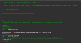

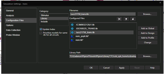

    But one more question regarding ISO5852S. We are trying to import ISO5852S_TRANS.lib to TINA but there is an issue like below.
    So I revised like below. Is it correct way for solving above issue? Will this affect performance of ISO5852S simulation?
    *.MODEL IGBT NIGBT
    *+ TAU=257.59E-9
    *+ KP=1.6467
    *+ AREA=8.0000E-6
    *+ AGD=3.2000E-6
    *+ WB=117.00E-6
    *+ VT=4.5775
    *+ MUN=3.2000E3
    *+ MUP=950
    *+ BVF=7.5320
    *+ KF=.5005
    *+ CGS=14.605E-9
    *+ COXD=13.357E-9
    *+ VTD=-5
    Would you recommend ref schematic of half-bridge  using  high side ISO5852S and low side UCC21750?
    The customer want to check DESAT function in half-bridge configuration using TINA.
    I can't open the schematic you shared. I don't know reason, It seems to be my program problem.
    Please let me know your opinion.
    Thank you.

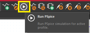

    But If click Run PSpice button, I can see below error massage, How can I debug this error, how can I run simulation to check other point?
    I am trying to study PSpice for TI using link you shared but Please help to solve this question.

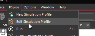

    I think this issues has to do with the library files path. Can you try below steps:
    1) Pspice -> Edit Simulation Profile
    2) Go to Configuration Files -> Library
    For each model library it is crying about, go to Browse, Select that library in the test bench folder, click Add as Global OR Add to Design. Either one.
    Let me know if this resolves your issue here. If not, would you please post a picture of the screen for configuration files like I did?

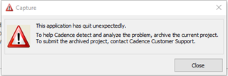

    If I click Edit simulation Profile like below,
    The PSPICE for TI program crashed with below massage. I already post this issue on Simulation, hardware$system design tools- Internal forum.
    I think this is not your job but is there any suggestion to solve this issue? This case is related customer request. please let me know your opinion.
    My program version is like below, How about your?
    Thank you.
  • Dino,
    That is error is strange. I am running the same version in Win10 and haven't ever had that before.
    Would suggest to try to reinstall the program / seek help from the PSPICE forum, they are experts on this tool and can better support.
    Best
    Dimitri

    But in case of my customer side, There is same error related C3M0032120J1.lib as mentioned before post.
    So I recommended 'edit simulation profile' as your recommendation but there is still an issue.
    Please refer to the below a picture of the screen for configuration files of customer. please review it and let me know your opinion.
    Thank you.

  • Dino,
    Try giving it the direct path for the C3M library. Delete that line by selecting it and pressing the weird looking X.
    Then select it again by clicking browse then add as global. It should show the complete path: (like "C:\Desktop\project\blah\C3Mxxxx.lib" rather than the relative path "./c3m.lib")
    Its possible that library is not in the same directory as the project, or in a different folder which might be causing this error.
    Let me know the result.
