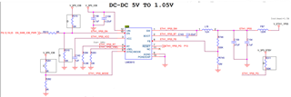

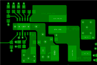

For our internal project we used LM63615DQDRRRQ1 buck converter for 5V to 1.05V (Output current=1.5A). Please review the design, layout and inductor chosen and let me know the comments.
Inductor(L16) Part Number : SRN3012TA-1R0Y

I don't see anything wrong in the schematic.
Please use the calculator tool spreadsheet for this device to unsure you have proper component selection.
You may want to leave a place holder on the PCB for a feedforward capacitor if needed (see calculator tool)
Ensure that the inductor is rated for the current limit of the device; about 2.5A
C158 and C156 could be closer to the device.
I would swap the locations of C159 and C154. Connect FB near to C154
I assume you have a good ground plane under the device to provide good heatsinking.
Please be sure to follow all recommendations in the data sheet.
Calculator is attached here.
