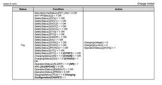

BQ4050: Charge Term Taper Current setting problem
Part Number: BQ4050
Hello,expert:
                        I found such a phenomenon when using the BQ4050: When the battery is charging, the SOC of the battery will become 100% at the current value set by the Charge Term Taper Current, and at the same time, battery will also be turned off for charging (turn off the charging MOS), is this normal?
