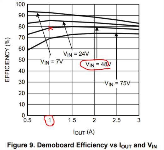

My customer is trying to estimate the approximate thermal performance of LM5576. The operating conditions is as below :
input 48V
ouput 28V/0.98A
27.36W(0.98A)
I have two questions regarding this.
1) Per fig. 9 in datasheet, the approximate efficiency would be 79%. Then,
Total loss : 27.36 * 21% =  5.74W
Inductor loss : DCR * 0.98A * 0.98A = 0.096 W
Diode loss : Vf * 0.98A = 0.48W
IC loss : 5.74W - 0.096W - 0.48W = 5.164W
Looks IC loss is too large. Can you check if the estimation above is valid?

  • Hi
    Webench result is right, normally in fixed Vin and Io, the loss will be similar, it is have little relation with Vo, so for 48Vin,  5V 1A, the power loss is 1.4W. when 28V output, the efficiency will be around 28W/(28W+1.4W)=95.2%

  • Kim:
    1 the efficiency curve you get from datasheet is EVM which is 5V output, for 5V 1A, the efficiency is 78%-79%, so loss will be (5*1/0.78)*0.22=1.4W

  • HI KIM:
    As I said, it will be slightly different by duty .
    You calculation for diode is right, and high side mosfet conduction loss = Io^2*D*rdson, diodes loss are Vf*Io*(1-D).. So when you decrease the diode loss, you will increase the conduction loss of high side fet, the total loss will be change a little bit.
    And switching loss is only related to VIn,Io ,inductor current ripple,  it is not related on Vo.
    the main loss is contribute by switching loss, conduction loss, diode loss , inductor loss. that's why the total loss will be close(but not same) in same Vin, Io but different duty condition.
