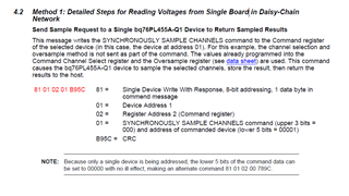

    This is use "Software Design Reference" document
    4.2 Method 1: Detailed Steps for Reading Voltages from Single Board in Daisy-Chain Network .
    in the GUI it can work normally,and easy to operation.
    when I command in the GUI  BQ76PL455 can response data for me.
    how could I do when I use the TMS570432 with bq76pl455.?

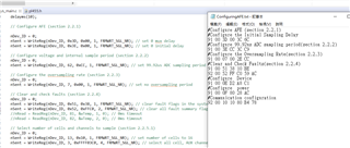

    I check the code in the CCS,the wakeup command as follow picture.
    Is the TOTALBOARDS should be set 1 ?
    Because I just only one board.
  • Hi Kuanlei,
    Ok does the wakeup command look the same from the GUI as from the MCU? Can you find any differences?
    Yes TOTALBOARDs should be 1. Could perhaps RX and TX be swapped on the MCU connections? Or some other misconnection?
    Did you change any of the example code or leave as is? Try not changing the code first.

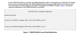

    Also did you try removing R8 and R9 from the MCU as below:
    Taylor
  • Hi Taylor Vogt,
    I'm already remove R8 & R9
    and I have a question
    when I set the same commend(Configure AFE (section 2.2.1))  in the GUI with CCS example code (NOT CHANGE CODE)
    The battery voltage will become 0V.
    Where should I need modify the Configure AFE ?
    I already refer to bq76PL455A-Q1 Software Design Reference
