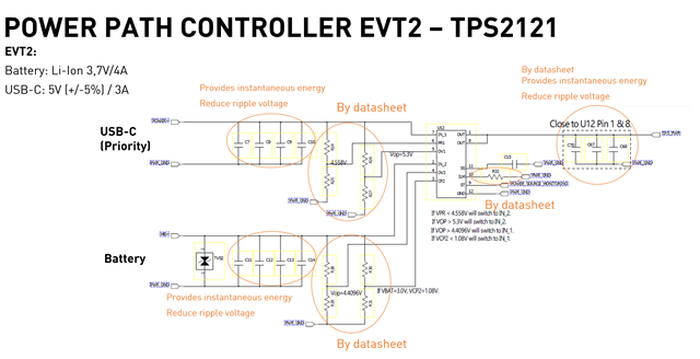

The team I am managing has developed a circuit with as input a USB-C adapter 5V(+/- 5%) 3A (priority) and a Lithium-ion battery 3,7V 4A. The PCBA has been produced and currently being tested with its load (LEDs, vibration motors, RF board). When starting the device with USB-C and battery connected, the device gives priority to the battery and not the USB-C. What could be the reason?
Additionally if only powered by USB-C the device does not manage to pass the self-test. The input voltage of the power path controller measured in that case is over or under the 4,75-5,25V at certain times.
Attached is:
1) a schematic: on the PDF one can click on the components for more details
2) An image of the schematics with note of USB-C input and battery input
3) Measurement of the voltage when the device is power on USB-C only during self test
Thank you in advance for support.

    Was the output enabled at any point during the USB-C only test? Typically when connecting to the load the supply voltage drops slightly; however, it seems to keep increasing (low res so it's difficult to say for sure but significantly increases). Is this supply connected through long cables and hot plugged?
    Can you please provide scope shots of the initial test (Both inputs high) with PR1, CP2, Vout and ST included? With PR1 and CP2 set as it says in the schematic it should prioritize IN1. If it doesn't it's likely due to a unstable supply. This device responds to the inputs it's given, so if the input keeps falling/rising significantly when the load is connected/disconnected then it's possible you'll see unexpected behavior.
    Could you also provide your resistor divider values for PR1/CP2/OV1/OV2?

  • Hello Maeva,
    According to your schematic PR1 is connected through IN1 via resistor divider network, yet PR1 is somehow high before a voltage is supplied to IN1. The same thing occurs with IN2 and CP2. Can you explain this since this shouldn't be possible? Also, it's important to show the ST pin signal in good resolution during events such as the solo USB-C test.
