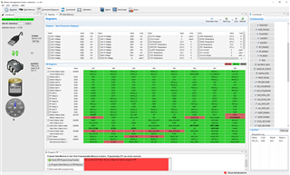

I got the BQ76952EVM which I hooked up to a 16S battery pack, then i have this screen:
I have a few question:
1.Is the startup OTP looks right?
2. Why do I have those certain alam enable bits enabled?
3. In the lowest windows I have checked if I can write the OTP or not, but it says the the BAT voltage is too high, why is is to?
My battery voltage is around 5240 * 10mV which can be seen in the GUI and also as I measured the on the VC16 bit..

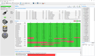

Also when I send on SET_CFGUPDATE command the OTPB bit should dissapear but it does not:
Also important thing is that when I set the bit OTPW_EN in the Mfg Status Init the OTPB dissapears but also CFGUPDATE bit.
