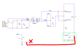

The customer wrote a schematic of DC LINK PRE-CHARGE.
An error occurs as a result of the PSPICE simulation.
1. Please review the schematic.
2. Please guide me on how to improve simulation error.

Hi Cho SR,
Thank you very much for reaching out with these questions.
1- The following recommendations in your schematics would help your system to reach convergence and to operate as expected.
- Remove the loading capacitor from VDRV since you are already loading the driver with the FETs
- Connect VSSS to the source of your FETs since you need to create a potential difference from Gate to Source in order to drive b2b FETs.
- Let's add a series resistor to your link capacitor to help the convergence
- Let's add a ground to you battery to help with convergence issues
- Let's eliminate the battery connection from ground to VSSS to eliminate any further concerns
2- I noticed that you are having convergence issues. We can also relax your convergence variables by using the auto-converge in the simulation configuration options.
I believe that these recommendations should produce the proper output in your simulations, but let me know if you have any further troubles.

Hi Francisco,
The customer revised the schematic map and tested it.
TPSI3050-Q1_Schematic_20211215.pdf
However, the capacitor is not charged and there is no signal from the VDRV pin.
VSS connection was removed and tested.
The results are the same.
It's the same result.

1- Disconnect the FETs from the driver and see if the driver is able to toggle VDRV high and low without load (place a 10nf for loading). I am recommending this because I see you are using a very small capacitance for the CDIV1 and CDIV2. These capacitance values should be about 10x your Cg. I noticed in the datasheet of the FETs you are using that Qg is about 45nC, therefore, you will need to increase these capacitors. I would recommend using 1uf for C1 and C2. If you get to see VDRV pulses, then connect it to the FETs.
2- Thank you very much for following the previous recommendations. I would recommend eliminating the connection to VSSS and for faster convergence, I would recommend connecting primary ground to the battery ground while testing these simulations.
