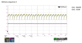

    The waveforms show as below.
  • Hi Carson,
    There is lot of switching on DGATE because of which the charge pump can be stressed. This can happen at no load or very light load condition or during AC rectification.
    1. Are you testing at no load ? If yes, Can you please increase the load current to a level where the DGATE stops switching and then check the charge pump voltage ?
    2. Is there ripple on input voltage ? The DGATE keeps switching if there is a voltage difference (enough to trigger Vsd(rev)) between input and output voltage.
    ==> Yes,  no load. We have confirmed that the charge pump voltage is OK when we increase the load current to 10A.

  • Hi Carson,
    Thanks for confirming on point 1. Please go through the below e2e FAQ to understand more on why gate oscillates at no load.
    Ideal Diode Controller or Linear ORing Controller Gate voltage oscillates at light load or no load
