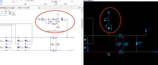

Can I Connect the input position of the adapter to the front of the bead and omit the EMI design on the recommended design, as shown on the right
Yes you can, but that will lead to lower EMI performance. The capacitors help filter high frequency transients, I would keep these.
