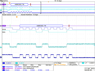

I am using the TPS55288QRPMRQ1 part on a board and I am unable to get it working with no progress or solutions. I have made sure that this is the I2C version. It has the same behavior on different boards with the same design. It is intended to be working as a boost convertor, taking in 5V and outputing 20V. Attached below is schematic for how we have the TPS55288 connected. One thing that was left out the design by mistake was a capacitor between Vout and Rsesne(R194) to ground, but this shouldn't affect the output when there is little to no load.
It will not communicate over I2C with a PIC microcontroller. This PIC is able to communicate with other TI chips on the board with I2C with no issues. It is not sharing I2C lines with any other chips so it should not be conflicting with anything else. Both the SDA and SCL lines are pulled up with a 1.5k ohm resistor to 3V3. On the oscilliscope, both lines are pulled up, and the correct address 0x74 is being sent. The address is set with a 0ohm on the mode pin.
The TPS55288 is also outputing the wrong voltage which was measured at 1.6V. This may be due to the fact that the 4h register is defaulted to 0 which uses the internal resistor divider but we would like to use the external one. We attempted to remove the external resistor devider R196 and R 200 and float the FB/INT pin. This resulted in the new output voltage reading 3V, but we are still unable to communicate with the device.
I have also tried increasing the ouput voltage from 5V to 20V and it had no impact on the output from the TPS55288. I am not sure what else to try at this point.

  • Hello Zack,
    I set Vin to 5.3V, with Vin being tied to EN, EN also equaled 5.3V. VCC measured to be 5.16V.
    I recorded the I2C output which shows that 0x74 is correctly being sent as a write, but the TPS55288 will not send the acknowledge signal. On the last clock cycle, the TPS55288 should hold SDA low. Due to the TPS55288 not acknowledging, my I2C program won't continue to send the data to program the mode register.

  • I have not replaced the IC yet, but since all of my boards are behaving the same way I don't think replacing one IC on one board will fix this issue. We would like to get an EVM board to figure out how this chip is supposed to operate, but everything is sold out right now.
    We changed the Mode resistor to 15kohm(should be 14.3k per the datasheet) to set the i2c address to 75H, still not receiving the ACK from the TPS55288. It could be the due to the wrong resistor value, but given that it won't communicate with the correct 0ohm mode resistor at the 74 H address, I was not surprised that this didn't work either.

  • I received the EVM and was able to program it over I2C and get an output. I still don't see anything that stands out on our board that would prevent this chip from communicating. It is interesting that this chip does not hold on to the programmed settings when turned off. I didn't see anything in the data sheet about it having volatile memory.
  • Hi Ryan,
    Thanks for the update.
    If the chip is shutdown, all the internal registers are rest to default values.
  • Didn't see that part, thanks for pointing that out.
    I was able to get the chip on the board working though. SCL and SDA were swapped on the footprint of the part. It was tricky to find but on the schematic the Net names were mixed up even though the schematic part was labeled correctly.  We were able to cut the traces and cross wire to get it fixed. Thank you for the assistance!
