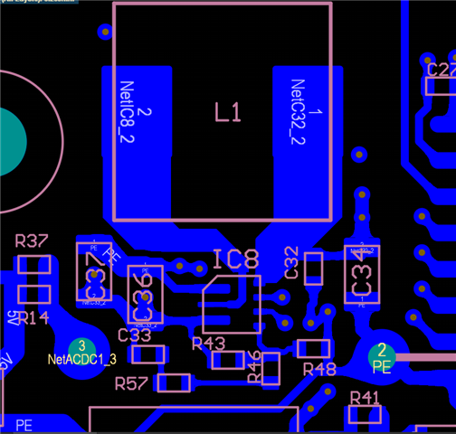

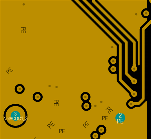

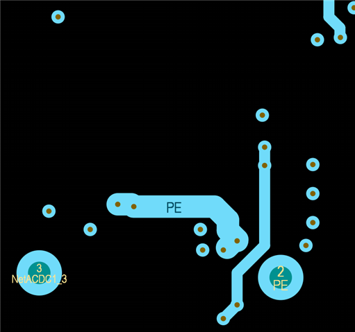

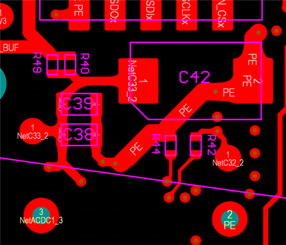

    Here are some pics of my layout. Would you recommend a snubber from SW to GND?

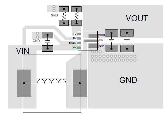

    Your layout is not good. The reason you see the damage is because your output loop (VOUT pin->output capacitor->GND pin) is long and thin. This will introduce excessive parasitic and cause stress to LSFET. This is a very common issue which happens to TPS61022 for a lot of cases. If you search the E2E about TPS61022 damage, you will get a lot of issue happening with same cause: improper VOUT loop.
    I would recommend you do layout change as same as what has been suggested in datasheet. For other layers, you can refer to layout in EVM user guide. After the layout has been modified, you can share the updated layout to me for review. Thanks!
