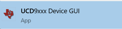

  • Hi, yes I was only updating the configuration with Fusion Digital Power Designer => configure device => Write to hardware => Store RAM to Flash
    And then after power cycling the board, I can't scan the UCD90160 anymore on I²C (worked perfectly before and with other boards too).
    Sorry I meant UCD90xxx device GUI (not guide):
    Looking in this forum I found this and then suspected the device was maybe in "rom mode"??
