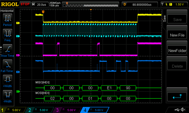

  • SDO goes high when HSEL is pulled low, then it stays high all the time
  • when sending a read or a write command, SDO stays high
  • write commands do not seem to register (reset, address claim...)
  • both ALERT_H and FAULT_H stay high all the time (ALERT_N and FAULT_N are connected to VBAT) - but of course I cannot read the registers!

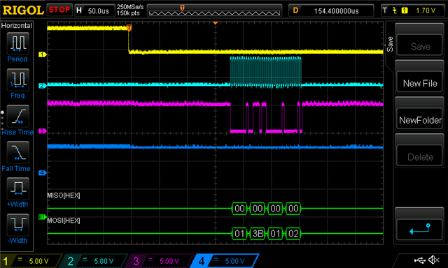

Write RESET

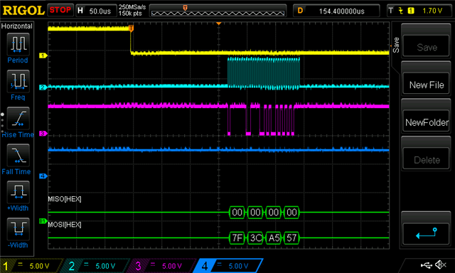

Write ADDRESS_CONTROL

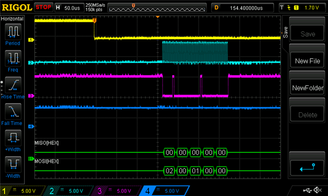

Read DEVICE_STATUS
I have tried to increase the delay between CS active (low) and start of clock, but that has no effect.
Is there something wrong in the command I send and that could create the problem?

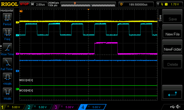

BBy the way, MOSI timing looks right for SPI mode1:

    After reading the datasheet again and again, I found the answer in the VBUS section 7.3.5 (p.29) that I skipped up to now as I do not use VBUS:
    NOTE
    Designer Note: North (_N) pins of the top, most-positive device in the stack should be connected to the BAT1(2) pins of the device for correct operation of the string. South (_S)
    pins of the lowest, most-negative device in the stack should be connected to VSS of the device
    After connecting those pins it now works as expected:
