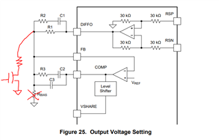

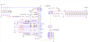

I am working on schematic design of TPS546C23 buck- regulator with the below requirement.
1. 0.95V/0.97V/1V@15A (Want to control through PMBus and Hardware
2. 1V@10/08A
3. 3.3V@13.47A
4. 3.3V@ 9.69A
I want to generate the output by using Hardware/ (by using FB pin and through) PMBus (by controlling the EN pin by Hardware/Software). Along with that I want to monitor the Voltage, Current, Temperature etc...
I am sharing the schematic with 1V@15A.
Can someone review it and provide the valuable inputs by generation the o/p with both the option. and how can I monitor the things.
PFA...
