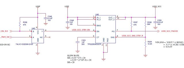

HI Team,
Vin,Vout =3.3V
Load current=1A
PFA schematics.
How much is the output capacitance to be used?
Kindly revert.

Hello Vidhya,
We generally recommend 1uF of input capacitance and 0.1uF of output capacitance for our load switches, but the output capacitance generally depends on your application. What ever capacitance you end up using you should make sure the inrush current drawn from it doesn't exceed ABS values and adjust your CT value to account for it.

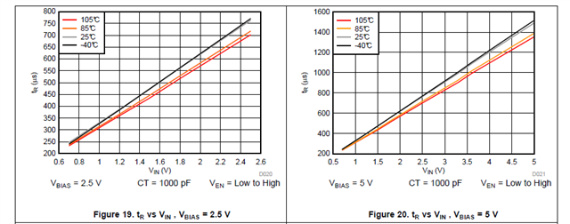

Hello Kalin,
CT value chosen to be 1nF.
There is no graph shown for Vbias=Vin=3.3V
As we have CT setting, 0.1uF output capacitance should be fine?
What is the rise time and slew rate for Vbias=Vin=3.3V?
Kindly revert.

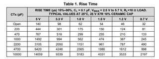

Hello Vidhya,
Yes, it should be for our device. The following table should apply for 3.3V = Vin = Vbias

Hi Kalin,
Vsense resistors are fine? Can you please confirm?
VSNS > 0.565V to drive PGOOD.
we have used 56K and 12K on 3.3V with VSNS=0.582V
Kindly confirm.
Vidhya
Hello Vidhya,
Yes, with R2 = 12kΩ and R1=56kΩ it means you'll achieve a valid signal by 3.2V, and invalid by 2.3V at the lowest and 2.8V at the highest. The 10.3K they currently have on the schematic doesn't ensure a valid voltage across the range.
