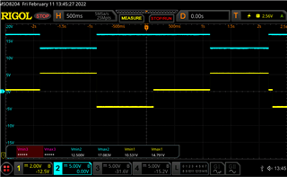

In this first oscilloscope capture for Cell 4, CH1 (Yellow) is the gate of Q4A, and CH1 (Blue) is the node between R21 and Q4A.  You can see that Q4A is clearly turning on under control of the BQ40Z80, as evidenced by CH2 (Q4A Drain) being pulled low by around 4V, causing balance current to flow through the 51R resistor.  (Note this was captured in Sleep mode, with CBS=1 hence the longer pulse times):
This is how I'd expect it to look for all cells undergoing balancing.

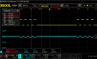

In the second capture for Cell 6, the same nodes are sampled around Q3A. Note that, despite the gate being toggled, the node at Q3A and R19 only drops by around 430mV, and thus a fraction of the desired balance current flows:
On a second battery pack I tested, the FET for Cell 6wasn't turning on at all.
These FET's have a very low VGHth of Max. 1.2V, so I would expect them to be fully on with 2V at the Gate.  I suspect a biasing issue of some sort.

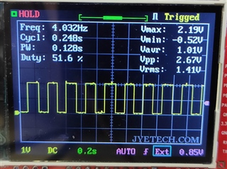

    I've also attached an oscilloscope capture demonstrating the Q3A Gate voltage of 2Vp-p (The oscilloscope was grounded to node 5P (ie. Q3A Source), with the probe tip at the Gate of Q3A.  2V seems a little low (I believe I've seen 4Vp-p on other cells balance FET Gates), however it should still be sufficient to turn the FET on.  I've purchased some alternative FET's (EM6K7T2R) which have a lower VGSth to trial, however this test will have to wait till I have time to build a new pack.
  • Hello Daniel,
    With the CBM enabled you should not see 4Vp-p between the FETs Vgs voltages, with the external cell balancing enabled it should only control one balancing at a time. If the CBM = 0 with external FETs it could lead to differences in the Vgs between all he external FETs with some being higher if they're overlapping.
    The Vgs of the external FETs should ideally be as low as possible, since the external balancing basically uses a resistor divider to create the Vgs, if the cells are at 3V and need balancing, the Vgs would be approximately 1.5V (with the default 1k ohm resistors in the external network).
