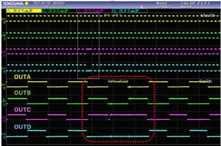

When the current limit works near the maximum duty, the OUT_C and OUT_D of UCC28950 outputs an abnormal waveform.
Can you tell me how to improve this abnormal operation?
DESCRIPTION
OUT_C becomes LOW due to the current limit, but after that (after about 20 ns), it returns to HIGH again for about 500 ns.
As a result, OUT_C turns on longer than usual.
During the next period, OUT_D should be HIGH, but OUT_D remains LOW and the OUTC side becomes HIGH.
Therefore, OUT_C and OUT_D, which should operate alternately, have abnormal outputs.
At this time, OUT_E and OUT_F synchronized with OUT_C and OUT_D also have abnormal outputs.
The OUT_A and OUT_B that synchronize with SYNC are normal.
In a more overloaded condition, the current limit completely limits the duty and returns to normal operation.
By lowering the current limit value or lowering the output voltage set value, it has been confirmed that abnormal operation disappears when the current limit is detected during duty control.
This phenomenon seems to occur when the current limit is detected near the maximum duty.
Shimamura.

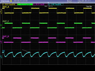

    This is the waveform at the time of abnormality including the waveform of the CS terminal.
    We have enough noise filters in the CS terminals.
    The current limit detection point is not 2V because overcurrent detection has slope compensation.
    The current limit detection can be imagined as having slope compensation like the white dotted line.
    Our phenomenon accurately detects the current limit near the maximum duty.
    When the current limit is detected, OUT_C goes Low once, but it goes High again after about 20ns.
    After that, OUT_D does not go High, but OUT_C goes High.
    During this period, the continuity to the secondary side is lost, and the voltage of the CS terminal also disappears.

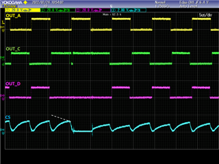

    This is a waveform with a further increased output current.
    Since the current limit is detected in each cycle before the maximum control, OUT_D (OUT_C) goes High before OUT_A (OUT_B) and operates normally.
