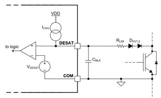

My customer would like to delete Rlim on DESAT port to increase the effective DESAT threshold. Currently they are using 1K series resister and 1ea HV blocking diode.
After deleting the series resister,  there is thermal issue on HV diode during normal operation.
I know that the internal current source flows to the collector through the series resistor and HV blocking diodes during normal operation. So I think the charge current(Ichg) is only 500uA which don't cause thermal issue when there is no the series resister.
Please review below question and let me know your opinion.
1. Is the series resistor(Rlim) mandatory option? If we delete the series resistor, is there any side effect like thermal issue?
  - Will Ichg(500uA) cause thermal issue on HV diode? or Is there another reason?
  - If deleting of the series resister cause thermal issue, please let me know your opinion regarding the reason.
2. The series resister(Rlim) is mandatory option, Is there any guide for Minimum value of the series resister(Rlim)?

  • Hi Vivian,
    Thank you for your response.
    Is there any other role of Rlim? Is there any other reason to cause thermal issue? The customer said that they only deleted Rlim.
    Currently, The customer is using USIM-E3, VISHAY diode as HV diode. And please refer to the below schematic and let me know your opinion.
    Thank you.
  • Hi Dino,
    Besides adjusting the DESAT threshold, Rlim also has some current limiting abilities. It can limit the current spike caused by capacitive coupling from the diode when the transistor is switching, and it can limit the current flowing through the diode if the reverse recovery time of the diode is too long. However, in this case, either situation is unlikely to happen - the capacitance of the diode is small (15pF), and the reverse recovery time of diode is short (75ns).
    Another role of Rlim might be related to the internal current supply (Ichg). It is possible that removing Rlim results in short in the circuitry, causing high charging current, thus high power dissipation in the diode. We will test the effect of Rlim on Ichg and get back to you.

  • Hello Dino,
    Apologize for the delayed reply. In my lab setup, I tested if the internal circuitry generating Ichg will be affected by the removal of Rlim, and the result is that removing Rlim does not significantly influence Ichg.
    From the waveform you provided, I can see that the peak current when the Rlim resistor is removed is high (342mA) due to reverse recovery. This can explain the heating up of the diode.
    We recommend putting in a Rlim resistor of 200 Ohms - 1 kOhm. Hopefully this will solve the thermal issue.
