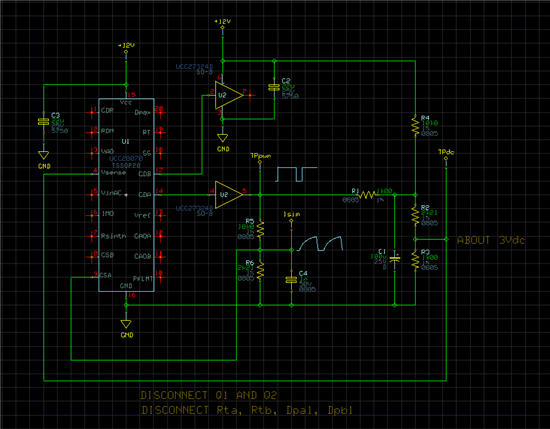

    Here is small schematic ,easy to apply in existing circuit tree, can help to simulate  proper work of controller . Playing with values of R6 and C4 you can check current limit and
    allso  with R3 output voltage.
    Dragan

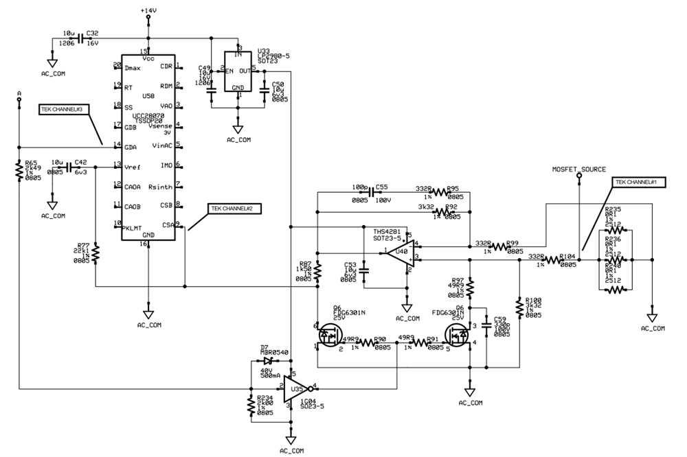

    Anyway, I am actually in contact with an TI engineer, and he asked me to do some measurement when the controller is ramping up.
    I uploaded them for you as well.
    One can see clearly, that the controller resets every 30 ms as soon as there is an VINAC voltage. Why he does that, I don't know yet. Maybe you can help.

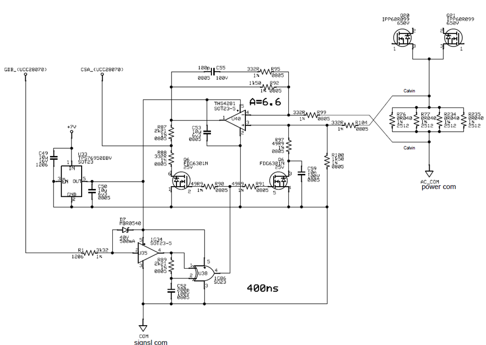

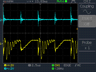

    hi Dragan
    we have been working with the PFC using 3.3 kw it is performing the function but the out put voltage starts to decrease as we put load and then never recovers .we are not sure about the current sense signals at CSB and CSA pins how the wave form should be .i have attached the picture in which yellow is the wave form at current transformer and blue is the curve at CSB pin but its looks that nothing is on CSB can any one explain that how the signal should be on CSB and CSA
  • Hi Imran,
    I am using this circuit for current sensing. Beside THS4281 (HS amplifier) are 1G34 and 1G86 in function to suppress noise  during OFF time. Working grate on 250kHz. Identical circuit is on  CSB side. It is not simple like transformer  but works better.  I hope I have working prototype in lab. and I am going to record all waveforms on UCC28070.
    Dragan

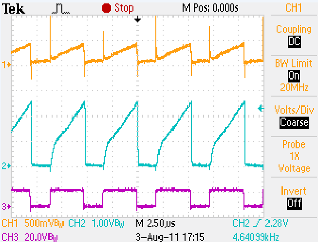

  • Irman,
    This is Schematic and w.f.
    Dragan
