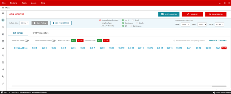

- Auto address function on BQAutoEval software does not work, the custom PCB is not detected on device selected drop down, as opposed to BQ79656EVM where it shows up as Stack 1
- Under cell monitoring window on BQAutoEval, "start polling button" is frozen, and there aren't any devices shown, as opposed to BQ79656EVM the device shows with voltage reading once polling button is pressed

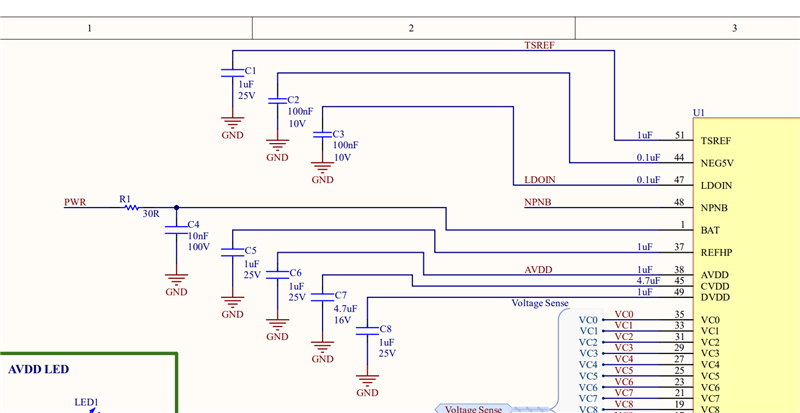

- All the voltages i.e. NEG5V, LDOIN, NPNB, BAT, REFHP, AVDD, CVDD, DVDD have been verified on custom PCB and compared with BQ79656EVM, they are correct
- One item that caught my attention was under the "Device Configuration Details" window that pops up upon first launch of BQAutoEval, there isn't any option to select BQ79656, the closest option is BQ7965x, which is fair as it might be same across other variants of this IC and it works fine with BQ79656EVM.

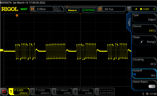

    Attached are four waveforms of zoomed in wakeup signal to see signal integrity.
    10cm in waveform 3 and 4 was used to verify shorter length cable in case longer length with hook clip may have been causing data loss; however, the response from custom PCB is still the same.

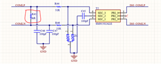

    I have attached schematics of the Custom PCB, transformer has been used in this implementation. Please have a look and see if all looks okay.
    1. BQ79656EVM with 30cm hook clip test probe
    2. Custom PCB with 30cm hook clip test probe
    3. Custom PCB with 10cm jumper cable
    4. Custom PCB with 10cm jumper cable zoomed in

    These waveforms look fine. I don't see any obvious issue with the signals. Can you confirm that these measurements were made on the custom PCB near the BQ79656 device (after the transformer)? If so, then can you check that the COMHP and COMHL connections are correct and not flipped? What voltage are you supplying the BQ79656 with?

    • One difference noted between BQ79656EVM and BMM PCB was that EVM uses inductor and capacitor configuration, as opposed to transformer configuration on BMM PCB. BQ79600EVM uses transformer configuration.
    • Amplitude of wave at the reception of BMM PCB BQ79656 IC was reduced, to verify this was not reduced significantly to cause malfunction, R45 was removed. Communication was still unable to establish.
    Resistor R45 in BQ79656 custom PCB

    Pin connection test:
    I also tried probing BQ79656 IC pins to the connector pins with DMM continuity on our BMM to check there wasn't any pin swapping or continuity issues and also checked the BQ79656EVM for reference. No issues were found.
    BQ79656EVM U1 (0CAJQLW XBQ7965x G4) pins:
    40: COMLP
    41: COMLN
    42: COMHN
    43: COMHP
    BMM U1 (12A2C1W BQ79656 G4) pins:
    40: COMLP
    41: COMLN
    42: COMHN
    43: COMHP
    Voltage Rail Check:
    I tried checking the voltage level on the power rails as well as some other DC nets to see if there were any power issues. I didn't see anything that looked unusual.
    C1 (TSREF) 2.55 mV
    C2 (NEG5V) -4.753 V
    C3 (LDOIN) 6.011 V
    C4 (BAT) 19.990 V
    C5 (REFHP) 4.994 V
    C6 (AVDD) 5.042 V
    C7 (CVDD) 5.042 V
    C8 (DVDD) 1.8095 V
    R8 (PWR)  19.996 V
    Q1 Collector 17.070 V
    Q1 Base (NPNB) 6.650 V

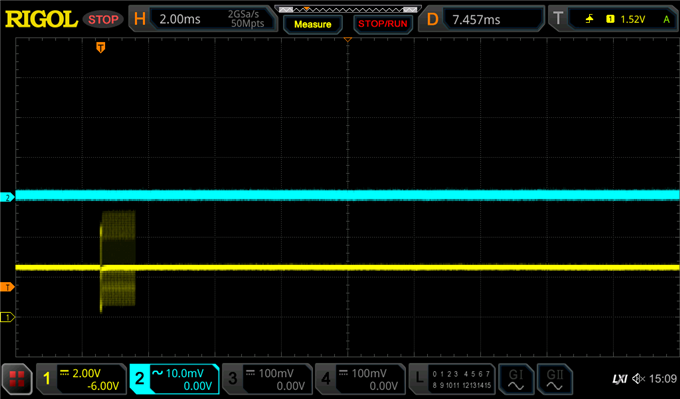

    I tried probing the power rails with a scope to see if it was a rail instability issue but I couldn’t see anything although I didn't test all the rails and doing such probing was a bit difficult with the on-hand equipment.
    CH1 is COMLN (Wakeup signal visible), CH2 is CVDD (C7).

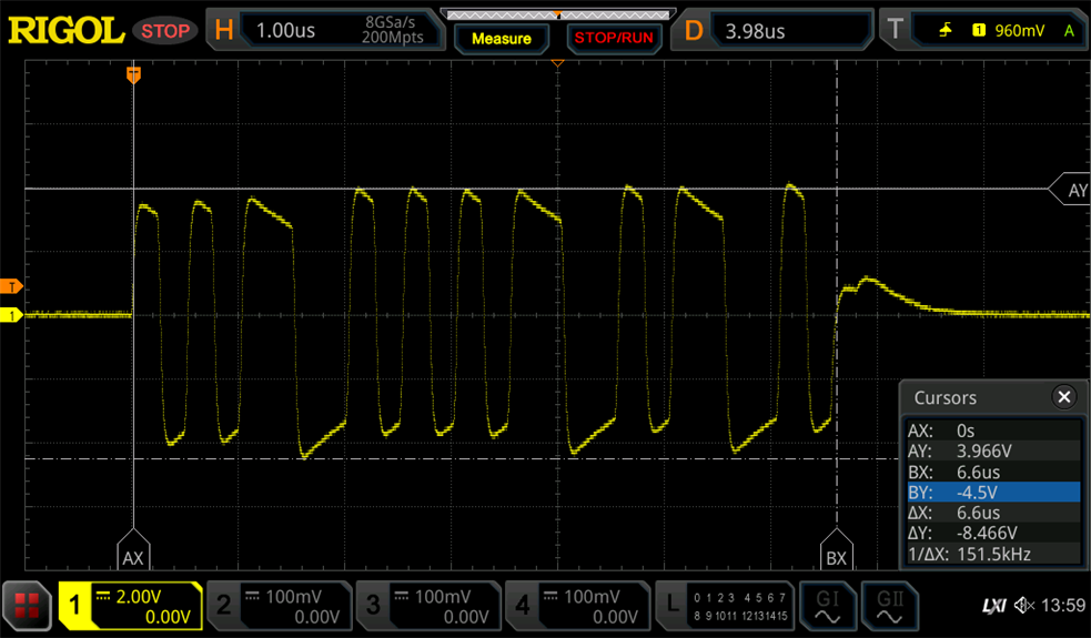

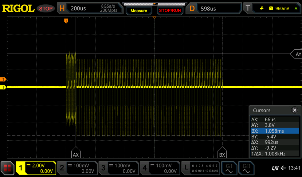

    I also tested signal integrity though out the signal chain, using both the BQ79600EVM and BQ79656EVM and did not see any issues. Below are waveforms probed at the BQ79656 IC pins. Probing was done across COMLP and COMLN using a 70MHz differential probe (HVP-70). Signal shown is the Wake up signal from the BQ79600EVM which appears to contain a "data signal" as well as a wakeup tone which makes capturing the waveform of both a bit easier but identical waveforms were observed when using the BQ79656EVM to drive our BMM as well as when attempting auto addressing, polling and power down commands. As can be seen there seem to be not issues with signal integrity, if anything the signal strength on our BMM is slightly higher than on the BQ79656EVM.
    Reference Wakeup Waveform on BQ79656EVM
     Complete wakeup signal
     Message data packet
     Wakeup tone waveform
    Wakeup Waveform on our BMM
     Message data packet
     Wakeup tone

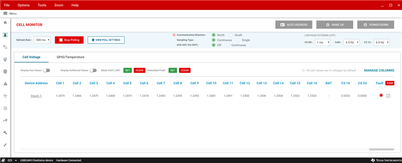

    I assembled two new boards (of our custom BMM PCB). Both seem to work fine so far. Both are able to wake up, auto address, poll and power down fine.
    Some initial cell voltage testing using a resistive divider string with 100 ohm resistors, similar to what's on the BQ79656EVM. Note there is no 16th cell in our application.
    Vbat = 20 V. Stack 1 is connected to the resistive divider string, Stack 2 is floating
    Increasing Vbat to 30 V. Stack 1 is connected to the resistive divider string, Stack 2 is floating
    Comparing to voltage measured by our BMM module with a measurements from a bench multimeter.

    BMM board 03, Not working (awake but unable to auto address):
    C1 (TSREF) 0.7 mV
    C2 (NEG5V)  -4.7491 V
    C3 (LDOIN)  6.0048 V
    C4 (BAT)  19.9979 V
    C5 (REFHP)  4.9927 V
    C6 (AVDD)  5.0376 V
    C7 (CVDD)  5.0187 V
    C8 (DVDD)  1.8058 V
    R8 (PWR)  2.752 V
    Q1 Collector 17.249 V
    Q1 Base (NPNB)  6.647 V
     BMM board 04, Working (Awake and address set)
    C1 (TSREF)  0.679 mV
    C2 (NEG5V)  -4.7525 V
    C3 (LDOIN)  6.0029 V
    C4 (BAT)  19.9982 V
    C5 (REFHP) 4.9929 V
    C6 (AVDD)  5.0484 V
    C7 (CVDD)  5.0231 V
    C8 (DVDD)  1.7998 V
     R8 (PWR)  2.737 V
    Q1 Collector 17.2652 V
    Q1 Base (NPNB) 6.6446 V
    Board 03 was retested again after 2 hrs and still did not work (wake up but no auto addressing)
    Board 03 was baked at 125°C for 2hrs.
    After being allow to cool back to room temperature (25°C) the board was tested again but did not work; able to wake up but not auto address or poll  etc.

     To reiterate and summarise I believe the issue is unlikely due to soldering or assembly because:
    • All solder joints looked good on visual inspection
    • IC responds to wake up signal and powers up
    • Self-derived voltage rails are all good
    • Signal was probed good on IC pins
    • Extensive reflowing and rework does not seem to affect the issue (neither better or worse)
    • The faulty boards can be made to fully function through a power cycling process
    The issue would seem to be related to the IC's internal power functions (but again all externally measurable voltages seem fine).
