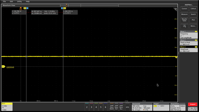

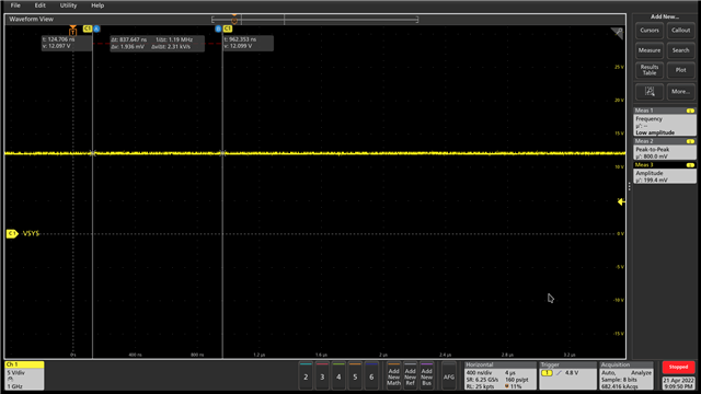

    • What are your power-up sequence settings? Since this is the user-programmable PMIC version I would like to confirm how you have the device programmed (Custom settings or still factory default). If you used the OTP Generator to program the device, a copy of the excel sheet would provide some clarity. Otherwise a full register dump with a short description of the sequence would suffice.
    • Can you provide a scope capture of VSYS, LDO5V0, LDO3P3, and BUCK1? If BUCK1 is not the first regulator to power up just substitute the correct output (this is just my assumption without knowing the power-up sequence). My goal is to follow the power-up process until the first fault is discovered and dissect the issue from there.
    James
  • Hi James,
    Waveforms and OTP details attached.

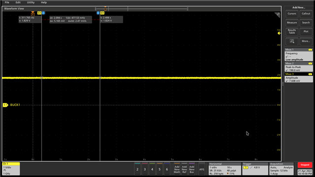

  • Hi James,
    Once the Buck 2 is enabled , Buck 1 output ripples are there. Without Cntrl 2 enable(Buck 2 enable)Buck 1 output looks fine
