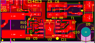

I am Farhad, I work on a project in which I have to regulate voltage from 48V to 5V with the maximum current consumption being around 50mA.
I used the WEBENCH POWER DESIGNER to have a good design with maximum efficiency for my project, but in the real situation after prototyping, the result is not as I expected.

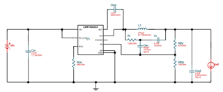

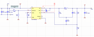

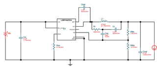

I attached the WEBENCH design and simulation result image and also my schematic here.
My schematic:

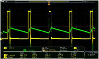

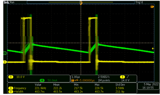

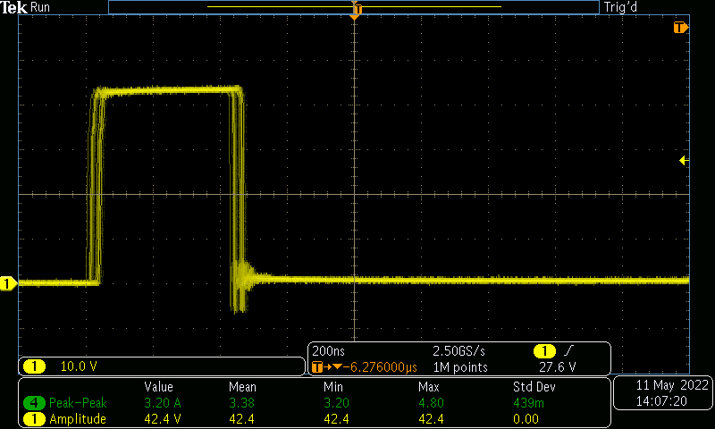

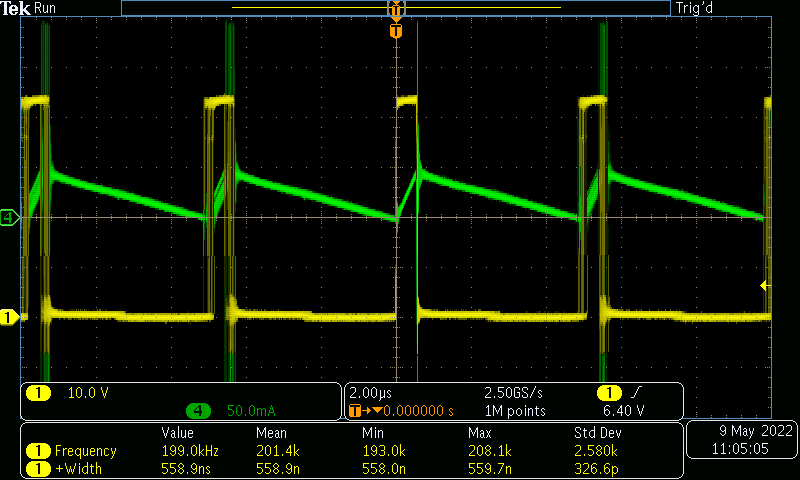

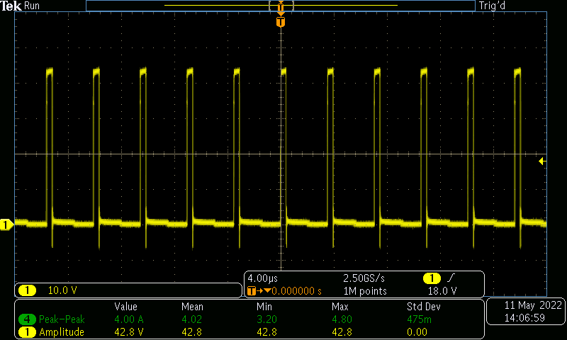

The problem is, when I scoped the switching voltage of the buck controller (Pin 8), It was unstable, and the frequency changed between 218KHz and 225KHZ, it was a shaky signal in the oscilloscope.
Simulation result:
Real result (Scoping):
CH1: Switching signal,
CH2: Inductor's current
Do you know what is the reason?
