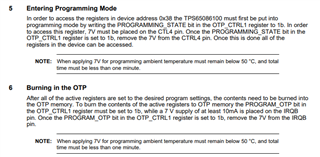

    as you mentioned "If you do programming once the chip is already on the MB, you will need a way to apply 7V to the CTL4 and the IRQB pins for the programming process", do you mean we need to apply 7V on CTL4 and IRQB always as the device mounted on MB?
    Mark
  • Hi Mark,
    No, these pins can be pulled up to their normal 1.8V or 3.3V source through a pull-up resistor if not being used for programming or for burning in the OTP.
    To be clear, CTL4 only needs 7V when you want to enter programming mode and change register values in the 0x38 I2C address. This is where you can find the default power up settings registers and the OTP programming register (R = 0x02). Registers in I2C address 0x5E should not need this voltage (things like changing the power rail output voltage).
     If you want to burn in your OTP settings, you must apply 7V on CTL4 to be in programming mode and get access to the 0x38 address. Then you apply 7V on IRQB and change the PROGRAM_OTP bit to "1" in register 0x02 to start the burn process. IRQB voltage should not go below 6.7V during the burn process. Once the burn is complete and you are done programming, you can reduce the voltage on these pins again.
    Pin descriptions from datasheet:
    OTP Programming Application Note excerpt:

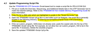

    Another question for Script Generator sheet of TPS65086100 OTP Generator Excel file.
    does it only fill in register value with manual? can we use IPGUI to export the Script Generator sheet? or any automatic  of method to export it?
    and do you have example file could to share with me ?
    Mark
  • Hi Mark,
    Once you get to the Script Generator, you can follow the instructions in the picture below. This comes from the BOOSTXL-TPS650861 EVM User’s GuideAfter you complete these steps you can move to the next section of the set-up process.
    I usually open the TPS650861-Script-xxx.js  file with Notepad to paste in the script.
    You may notice that there is already a script inside the file. This script can be either left alone or deleted. If you leave the original script in the file, just make sure that the new script you paste inside has a different name at the top as pictured below:
    These are two different custom scripts pasted into the file. As long as you change the highlighted hex numbers to a unique code for each script in the file, you should have no conflicts. The order of the scripts does not matter (the FF script can be pasted before the 00 script with no issues for example).

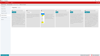

    Once you do this, you should be able to see each individual custom script in the IPG-UI device screen shown below:
    You can see the two highlighted custom scripts are displayed in the drop down list (plus some others that were not shown).
