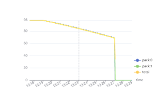

We used BQ40Z80 Impedance Track Gas Gauge. In hte discharging situation, the SOC jump to zero. We have fixed the cell risiatance. In tne diacharging situation, the cell temperature is continous dwon. So we this may be related to temperature modoul.
We use  BQ40Z80 Impedance Track Gas Gauge。During discharge,the SOC jumps to 0. We have fixed the battery internal resistance. Therefore, we speculate whether the temperature model causes the jump. Because during the discharge process, the temperature continues to decrease. Is it the temperature model that predicts low temperatures in the future, causing the jump? Which command should we use to verify this conjecture?
Or the wrong Rb value causes the calculation of the low temperature cell resistance to be too large. Which command should we use to verify this speculation?
Also how does the temperature model work? Do temp K and temp T change during discharge?

    The following are the data recorded by studio during the discharge process, and the gg files before and after the discharge.
    What does CompRes stand for? Why did CompRes change so drastically, and what caused the change in CompRes? Why does it happen that CompRes is equal to 0?
    What does RaScale stand for? Why did RaScale change so drastically, and what caused the change in RaScale? Why does it happen that RaScale is equal to 0? Is Ra scale equal to the ratio of CompRes at different times?

    The CompRes is the temperature compensated resistance, essentially the value used for the CUVC calculation. These resistance register values are probably changing so drastically for multiple reason.
    1 is that the cell resistance was manually modified and the gauge is trying to compensate for incorrect Ra table.
    2 is that the temperature is decreasing rapidly during discharge, this may cause the gauge to misinterpret the self heating of the battery. If a test is performed without dropping the temperature during discharge, does the RSOC jump still occur?
    I also noticed your DOD0 is 0 for almost all of the cells, this indicates that the chem ID chosen is not a good match and you are operating outside the range of the chem ID.

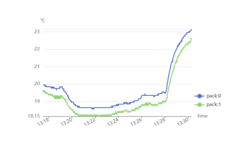

    Also, why is the temperature change so small in the graph below but the CompRes change so drastically?
    Is Ra table the resistance of the cell at 25°C?
    Also what does Rascale stand for? Is it the rate of change of the internal resistance in the Ra table in the gg file? Or is it the rate of change between Ra at the current temperature and the last time Ra? Or the rate of change between resistance at the current temperature and  the Ra in gg files ?
    Rascale=new Ra/old Ra *1000?
    In the figure below, CompRes is equal to 125, but Rascale has changed from 1000 to 158. Why is this? What does it stand for? Why does TrueFullChgQ bounce back after Rascale gets smaller?

    The CompRes is not always active and is meant as a tool for debugging operation and should not be used as a direct substitute for the Ra table. CompRes is not calculated through the whole discharge period.
    RaScale decreases because the internal resistance needs to be scaled down in the fast scale region since it was artificially set so high.
    You will not be able to get any good results until the Ra values from the learning process are used. I would also recommend changing your load select to Average Current instead of the max value.
    Have you performed tests without dropping the temperature during discharge? Are the test results better? If the temperature is decreasing during discharge by significant amounts it may lead to the thermal modeling predicting the wrong temperature coefficients.

    Q7:In analyzing the data, we found that the SOC jumps occurred in the scene where the temperature dropped from above 10°C to below 10°C. why is that? Is 10°C a special point in a fuel gauge?

    So when the cell is discharged at room temperature without decreasing it during discharge, the gauging is accurate? If this is the case the reason for the RSOC jump is most likely due to the thermal modeling, the gauge predicts that temperature should increase during discharge, but the tests being performed are forcing the temperature down while there is a discharge.
    The thermal modeling done internally is complex, the gauge takes into account thermal heating of the battery to help predict the internal resistance. If you dramatically decrease temperature while discharging, the gauge will be predicting the incorrect resistance at later discharge points. If you are starting at room and doing extreme temperature change to lower values while discharging, there will most likely always be some RSOC jump.
    As mentioned on the last response, you will not get any good gauging until the learning of Ra is done reliably and not modified. This would be the highest priority on the list of most likely to cause issues is RSOC jumps.
