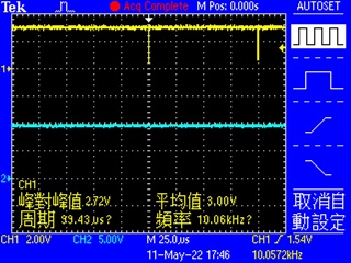

We have two backlights, old and new, with the same driving conditions,
oldnew
When using the old backlight, the brightness can be controlled normally by PWM (PWM frequency is 10KHz),
but using the new backlight, the PWM doesn't work properly.
The schematic diagram is as follow:
What could be the reason for this?

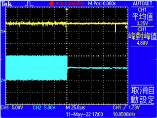

  • HI Mason,
    IC was purchased from the distributor Arrow Electronics.

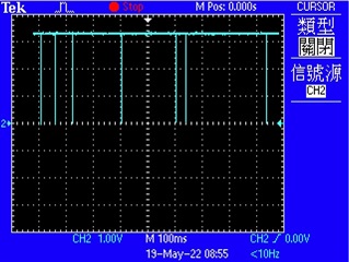

    The waveform of the CTRL pin is as follow:
    But using the new backlight, the PWM doesn't work properly.

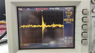

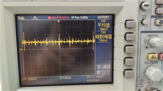

  • hi Leo
    How do you provide the PWM signal, by MCU or wave generator?  compared with old one, it seems there is additional pull-down for new backlight. Is there any regular pattern for this phenomenon? Any difference for the changing of frequency or duty cycle
  • I provide PWM signal from MCU. The frequency of the new backlight is wrong and irregular during PWM operation.

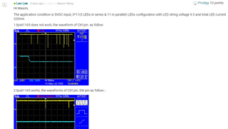

  • hi Leo
    For new backlight device, please help check following items:
    1. condition: MCU PWM applied at ctrl pin, tps61165 does not work, provide waveform of Ctrl pin
    2. condition: MCU PWM applied at ctrl pin, tps61165 works, provide waveforms of Ctrl pin, SW pin, VLED, ILED.
    also I would like to confirm the application condition: 5VDC input, 3*11 LEDs configuration with LED string voltage 27.9 and total LED current 220mA?
    thanks
  • Hi Mason,
    The application condition is 5VDC input, 3*11(3 LEDs in series & 11 in parallel) LEDs configuration with LED string voltage 9.3 and total LED current 220mA.
    1.tps61165 does not work, the waveform of Ctrl pin  as follow:
    2.tps61165 works, the waveforms of Ctrl pin, SW pin as follow:.:
  • hi Leo
    From the result, it seems the PWM signal at ctrl pin is not normal even when TPS61165 does not work. can you check the signal from MCU, if it has interference during the path?

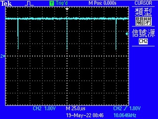

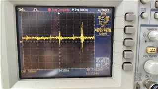

  • Hi Mason,
    Now the new backlight uses TPS6115, PWM can't work normally, I replace it with other compatible IC (not TPS6115), PWM can work normally. Not a different batch of TPS6115.
    Using the TPS6115 with the new backlight waveform is as follows:
    Vin=5V, yellow is CTRL, bule is VLED.
    yellow is CTRL, bule is SW.

  • Hi Mason,
    Please refer to the waveform of ES mode, but the dimming is still not possible using PWM mode. Remove R40 and R41 at the same time, PWM mode and ES mode cannot be dimmed.
    waveform.rar
  • Hi Leo
    sorry currently I cannot connect to E2E website on my PC while I fail to decompression the file on phone. I will try again and feedback to you as soon as I fix this
  • hi Leo
    From the result of Vin, SW, VLED, it seems the operation is normal with Vin=~5V, VLED=~9V and SW 1.2MHz frequency shown in the waveform. Any result for the FB voltage (or LED current) under 25%, 50%, 100%?
  • Hi Mason,
    FB voltage 25%, 50%, 100% is as follows:
  • hi Leo
    It looks like the FB voltage follows duty cycle change. can you help clarify again on "dimming is still not possible using PWM mode". So far, the waveforms of FB, SW, Vout seems OK.

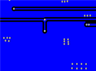

  • Hi Mason,
     The layout file for both old and new backlight boards are as follow:
    OLD backlight.pdf
    NEW backlight.pdf
  • hi leo

  • hi Leo
    not sure if they are right files as looks like not PCB layout file.
  • Hi Mason,
    I only have this PCB layout file in my backlight specification.
  • hi Leo
    based on my understanding, this is actually a PCB manufacture file rather than PCB layout file. I cannot figure out how components including IC are placed and how traces are routing, how GND plane is placed.
  • Hi Mason,
    The PCB layout is as follow:
    Top layer:
    Bottom layer:
