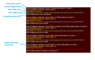

We are developing a tool to program our devices on the production line. It perform the following sequence:
  1. Read the gg.csv file exported by Battery Management Studio with our final configuration
  2. Read the data flash from the device using the block read command (0x44)
  3. If the values don't match, write the new values
We have observed the following:
  • All block reads are 32 bytes
  • Block reads work perfectly for any register longer than one byte.
  • All single byte register reads fail. They seem incompatible with block read.
  • I can't find any reference in the register guide to dataflash "word read". It covers word write and block read/write.
  • Note the sequence below is missing the second 0x44 byte issued before the read starts.
  • Update:
    By creating a special condition for 1-byte registers we can now read 525 out of 539 registers correctly.
    Dear TI, what's the deal with different IO behaviour for different registers?
  • By using the same hack for 1-byte and odd-addresses we can now read all but 2 registers.
    Did everyone else have to reverse engineer this?
  • The last registers are read-only (Manufacturer name, device name) so we're going to say this is resolved. Here's my code from my PC app:

    And here's my MCU code which is mostly pass-through except for setting the read length. I don't think the delays are required but i didn't want to remove them for a one-time operation:

    Hope that saves someone else 2 days!
