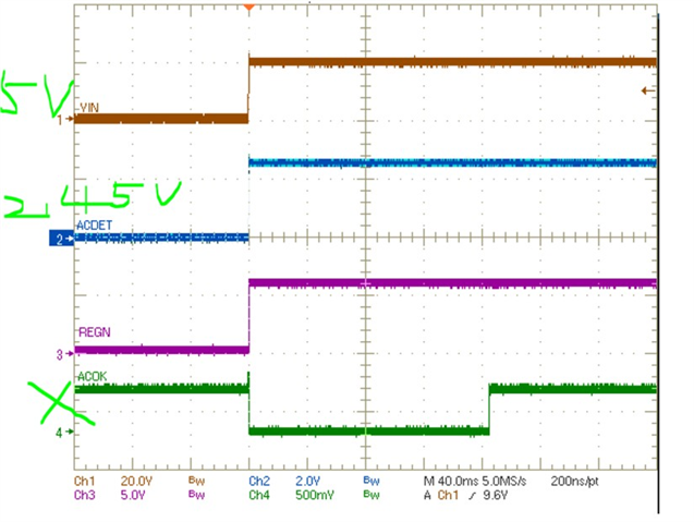

The scenario is adapter 5V/2A in & no battery. Why is ACOK always high? Vin is 5V , ACDet is 2.45V , but ACOK is high constantly. From datasheet , ACOK pin have a low status for a period.
Johnny
Johnny
Hello Johnny,
ACOK is an active high AC adapter detection open drain output. It is pulled high when a valid adapter is present , that is, when the following conditions are met:
ACDET above 2.4 V, VCC above UVLO but below ACOV and VCC above BAT.
If any of the above conditions is not valid, ACOK is pulled LOW by internal MOSFET
Are there any issues in your system when using this feature?

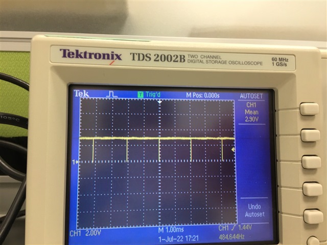

Hello
The signals of BATPRES# is High and low switching alterntely. Why has this issues?
thanks
Hello Johnny,
Could you please clarify what parameters are being set. What values are set for VIN, Charge Voltage, Charge Current Registers, etc? BATPRES is an active low pin, if battery is present, the reading should be low consistently. Your adapter voltage might not be high enough, please provide additional information. Thank you

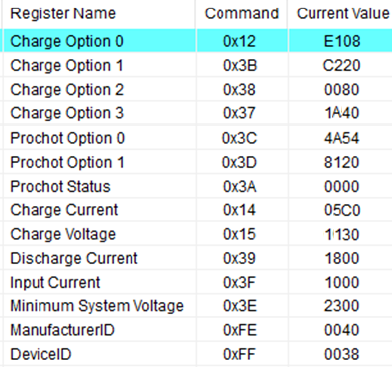

Registers setting
0x12H Options Control 0: 0xE108
0x14H Charge Current Setting: 0x05C0 (1472mA)
0x15H Charge Voltage Setting: 0x1130 (4.4V)

Registers setting

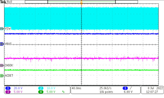

Hello Johnny,
What I can recommend to debug is to capture a waveform of the switching node, if the capture is switching, then the charger is functioning. On the first waveform, Vin is shown to be 20V, can you please verify the value of Vin. If ACDET is 2.45V, Vin should be closer to 20V. I would also advise to verify the values of the resistor-divider on ACDET. Using 866kOhm and 133kOhm resistors for this resistor-divider will require ~17V for the charger to charge.

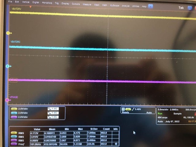

Current condiction : 5V/2A . Vin=5V. ACDET=2.45 , BATPRES# is active low. BATSTAT# is low.
Issues : BATDRV & BATSRC are the same voltage instead of V(BATDRV) - V(BATSRC) = 6V.
How to turn on BATFET?
thanks
Hello ,
Disable Watchdog : VBATDRV:4.14V & VBATSRC:4.14V
Remove Adapter & battery only : VBATDRV:4.14V & VBATSRC:4.14V
Hello Johnny,
Upon configuring my EVM board to the information that you have provided, I was able to capture a switching waveform. I have attached my findings. What I would advise at this time is to order the BQ24800EVM and follow the EVM User Guide above as it shows step by step configurating for successful use of the device.
