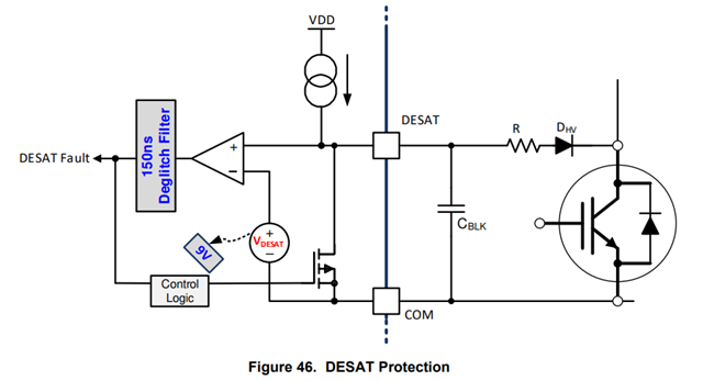

3) Can I get a faster SC response by eliminating the Cdesat Cap?

    3. Are you talking about the blanking capacitor Cblk in the figure below? We would not recommend eliminating it as Cblk help with noise immunity on the DESAT pin.

    For 3), after a blanking time of 200ns, what is the minimum total desat detection + soft turn off than can be achieved by the gate driver? Can you share any design guidelines for that?

    The 21710 datasheet and 21750 datasheet has schematics for the DESAT and OC design. Additionally, you can check out this calculator that calculates the detection threshold, blanking time, etc. The calculator can also calculate the soft turn off time.
    Be aware that besides the leading edge blanking time, UCC21750 also has DESAT deglitch time (150ns) and DESAT to OUTL propagation delay (200ns) that all should be counted towards the total turnoff time. UCC21710 does not have the leading edge blanking time, but has OC deglitch time (120ns) and OC to OUTL propagation delay (270ns). All specified in the datasheet.
