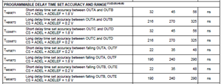

    There should have been a 15 difference in the TAFSET delay by change R8 from 56.2k to 64.9 k ohm.
    Could you look at OUTA and OUTF directly to see directly what the turnoff delay is?  It should have change 15%. You had mentioned the delay was between 1.08 us and 1.84 us.
    Based on the calculations, with an Ref(R8) of 56.2 k the delay should have been 110 ns.  With and R8 of 64.9k the delay should have been 126 ns.  Your delays are much larger than this an appear to be be moving with load.  They should not if ADELEF is shorted to ground.
    You might want to double check the resistors your change as well.  Because changing R8 should have had an effect on these delays.

    I looked at your waveforms and they are all taken on the gates of the FETs.  Could you retake these waveforms at OUTA, OUTB, OUTE and OUTF of the UCC28950 controller?  There should not be a turnoff delay moving with load in regards to the UCC28950 if ADEL and ADELEF are tied to ground with zero ohm resistors.
    You are basing your delays on how long it takes for the FETs Vds to go low.  Even though OUT E and OUTF from the UCC28950 has gone low.  There is going to be a further delay by how long it takes the driver to pull the gate from 12V down through the miller plateau down to Vgs.  dt = dQ/Idrive
    I think if you retake these times and look at the outputs of the UCC28950 the delays will not move with loading, if ADEL and ADELEF are shorted to ground.
    The equations for TABSET, TCDSET, TAFSET, TBESET in the data sheet describe the delay timing when ADEL and ADELEF are set to 1.8V.  When ADEL and ADELEF are grounded I believe you have to add additional 50 ns to the equations given in the data sheet.

  • Hi Mike,  would you mind helping clarify the following:
    1)  Is it OK to have tABSET, tCDSET fixed, while have tAFSET adjustable?
    2)  We can tie tAFSET to 1.8V for all loads (using voltage divider RAEF/RAEFHI  to VREF instead of tying to CS) and get a fixed tAFSET value.  The value obtained for tASFET in this manner would be higher than the tAFSET value obtained when RAEF is tied to ground (assuming REF is the same in both cases).
    Nitish
    1.   Functionally you should be able to have TABSET and TCDSET fixed, while having TAFSET adjustable. In general customer's either use adaptive delay for all the delays, or they used fixed delays.  However, it does not mean that you can't make TAFSET adaptive.  So I don't see why you can't try this approach.  With all designs it is necessary to verify your design with production and worst case testing.
    2. The delays should be higher if ADEL and ADELEF pins art tied to 1.8V  Please see the test data below.
