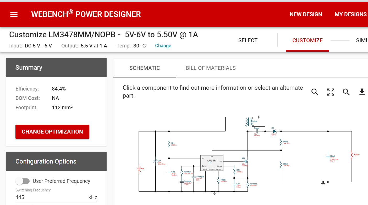

  • Hi Feng,
    The attached is the result of simulation at WEBENCH.
    The output power is 5.5 W and is much larger than 80 mW.
    5V and 2A circuit diagrams are also shown on the first page of the data sheet.
    Is our condition (parameter) outside the simulation guarantee range?
    Then, please teach how the circuit design should be carried out.
    Beat Regards,
    Tom Liu
  • Hi Tom,
    I am confused. I could not see any file attached.
    What is you output power? 5.5W or 80mW?
    Feng Ji
  • Hi Feng
    Sorry, I forgot the attached.
    The output power of the attached if 5.5W.
    Beat Regards,
    Tom Liu
  • Hi Tom,
    From your first post:
    The design parameters are as follows.
    Vin = 5V
    Vout = 40V
    Iout = 0 ~ 2mA
    Fs = 500 ~ 600kHz (changeable)
    From your last post:
    Vin = 5-6V
    Vout = 5V
    Iout = 1A
    I suppose these are two different applications. Which is the application you want to discuss in this thread?
    Feng Ji
