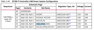

I tried to reprogram the VADJ voltage to 1.8 V. I followed the step-by-step instruction for using the digital power manufacturing tool and finally I got this error:
I googled the error, Xilinx guys are suggesting using Fusion Digital power designer instead. According to the Xilinx ZC706 user guide:
Setting Rail #4 to 1.8 and writing it to hardware does not solve the issue.
After trying the digital power manufacturing tool and Fusion Digital power designer, the VADJ voltage logged in the UART console is 1.2 Volts and I can't adjust and bring back the VADJ voltage to either 2.5 or 1.8 Volts!!
Any help is highly appreciated!

    UCD90120A is a sequencer, how do you adjust the VADJ voltage vis UCD90120A?

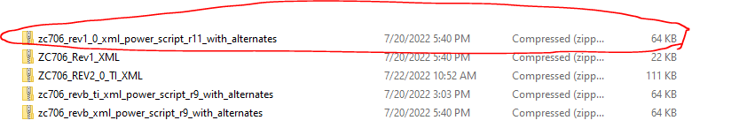

  • After Fusion Digital power designer scan on the PMBus, while the USB-to-GPIO adapter is connected to the ZC706 and the board is powered on, it finds the UCD90120A Addr 101d(65h), please check it below:
    I bought the board recently so revision 2.0 is the PCB revision!
    I’ve tried all provided revisions but with no success (mine is r11)!
    Since I would like to set the VADJ voltage to 1.8 Volts I load the XML file from the 1v8_VADJ folder(please find it attached)

    UCD90120A is a sequencer and it can not change the output voltage of the monitoring rail.
    What you can change the monitoring threshold in the GUI but these threshold will not be transferred to the power IC.
    Instead, the UCD90120A must be configured to match what the power IC can do.

  • Hi
    The file was not generated from Fusion GUI.
    Please follow this video to export project file.
    https://training.ti.com/fusion-power-designer-import-and-export-project-files?context=1136655-1139495-1136588

    I need to reprogramm the VADJ voltage on ZC706 EVB. According to this link,
    As you follow the link in the AD wiki page it will direct you to the Xilinx forum. I followed the instruction in ZC706_Power_Controllers_Reprogramming_Steps.pdf. It results in a failure.
    According to the post here. It not clear what needs to be done, to configure ZC706 evaluation board VADJ for 3.3V or 2.5V or 1.8V.

    The links was not right as you can see UCD90120A can not control the output voltage.
    The project file you shared has 1.8V at the VADJ. there must be something else in the hardware to adjust the output voltage of the VADJ power supply.t

  • Hi
    At least, UCD90120A is not the one to control the output. is there a switch on the board to adjust the output?
    UCD90120A is to monitor the output voltage and it shall be adjusted accordingly based on the real voltage of the power supply.
    Manually adjusting the voltage from 2.5 to 1.8 in the configuration file does not change the output of the power supply.
    I strongly recommend contacting the original designer or review their board user guide to see whether there is way to adjust the output.
